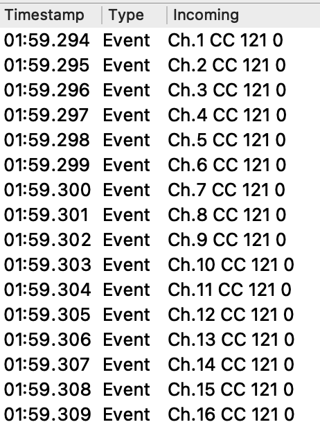

if you hook up your MH to itself as a test, you’'l see the send controller reset messages option just does this
(note the 1ms gap between the messages)

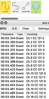

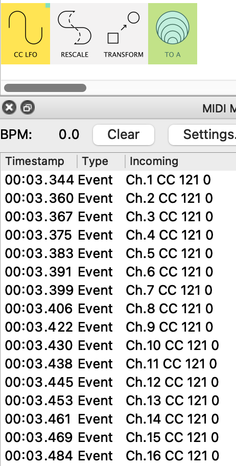

The LFO method looks like this
(this demo is buried at the bottom of a long preset I’m working on so I haven’t uploaded it: lemme know if you get stuck)
