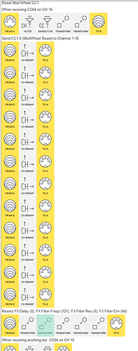

Hi there, My original goal is to be able to reset the ModWheel macros (CC1) on all the tracks of an Electron Digi box (Digitakt, Syntakt) without mapping all tracks to the same midi channels on the digi box.
I am trying to find out if there is a more elegant way to send CC1 = 0 to channels 1 through 16, in the same way a dispatcher does that with notes?
So far I only was able to do this by creating a virtual pipe per channel, but was wondering if there was a more efficient way to do this?
Syntakt1.mhp (1.1 KB)

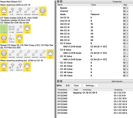

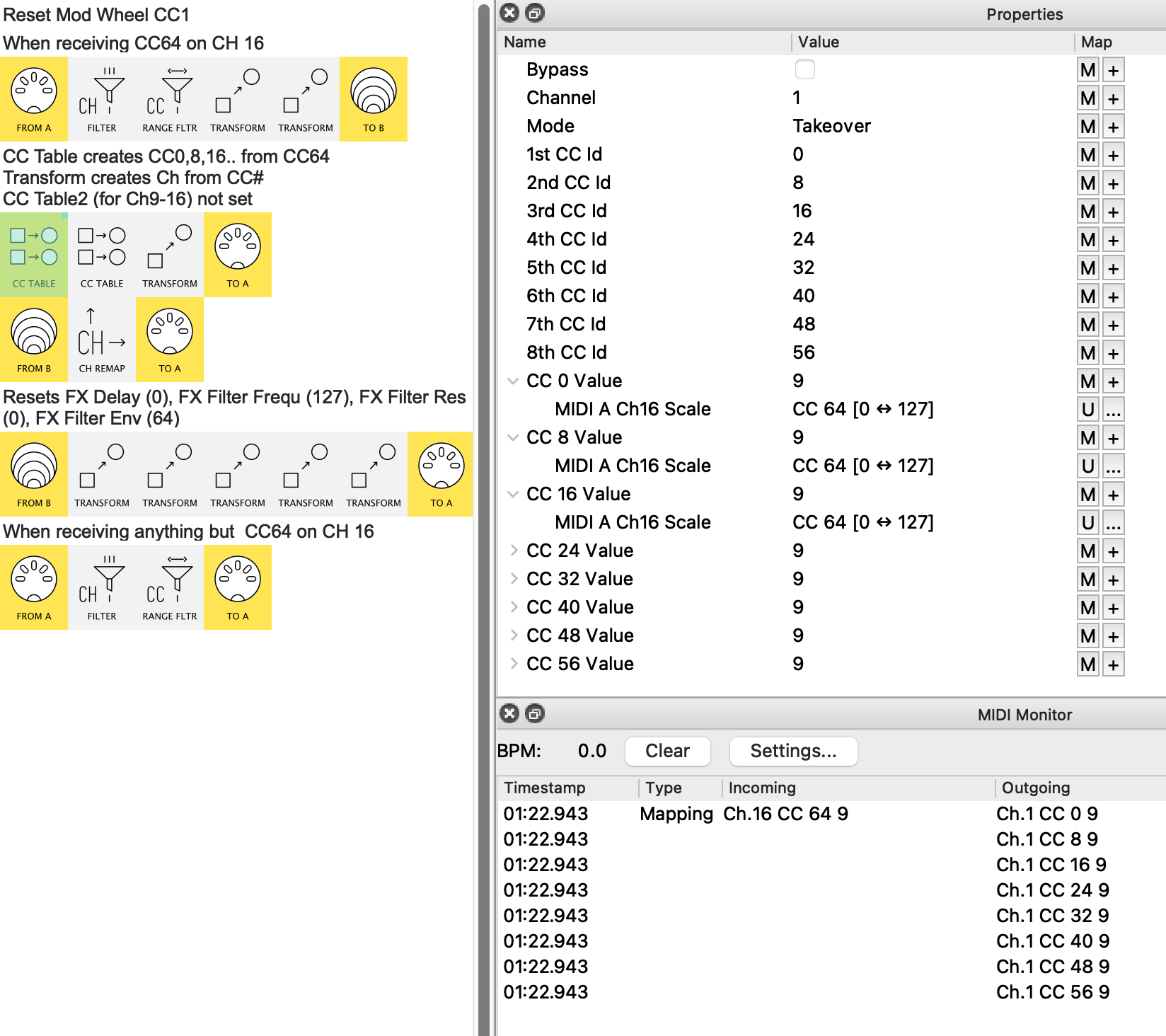

CC Table
although you mention using Ch1 CC1 value 0 as your trigger, your line one creates this from any value of Ch16 CC64.
So let’s use that directly:
(I’ve set every “value” line to MIDI A Ch16 CC64)
Now, I’m setting the CC ids to 0,8,16,… for channel reasons.
I don’t care about the Channel value so I leave it at 1
See that the Monitor shows those 8 x CC values (here value = 9) coming out

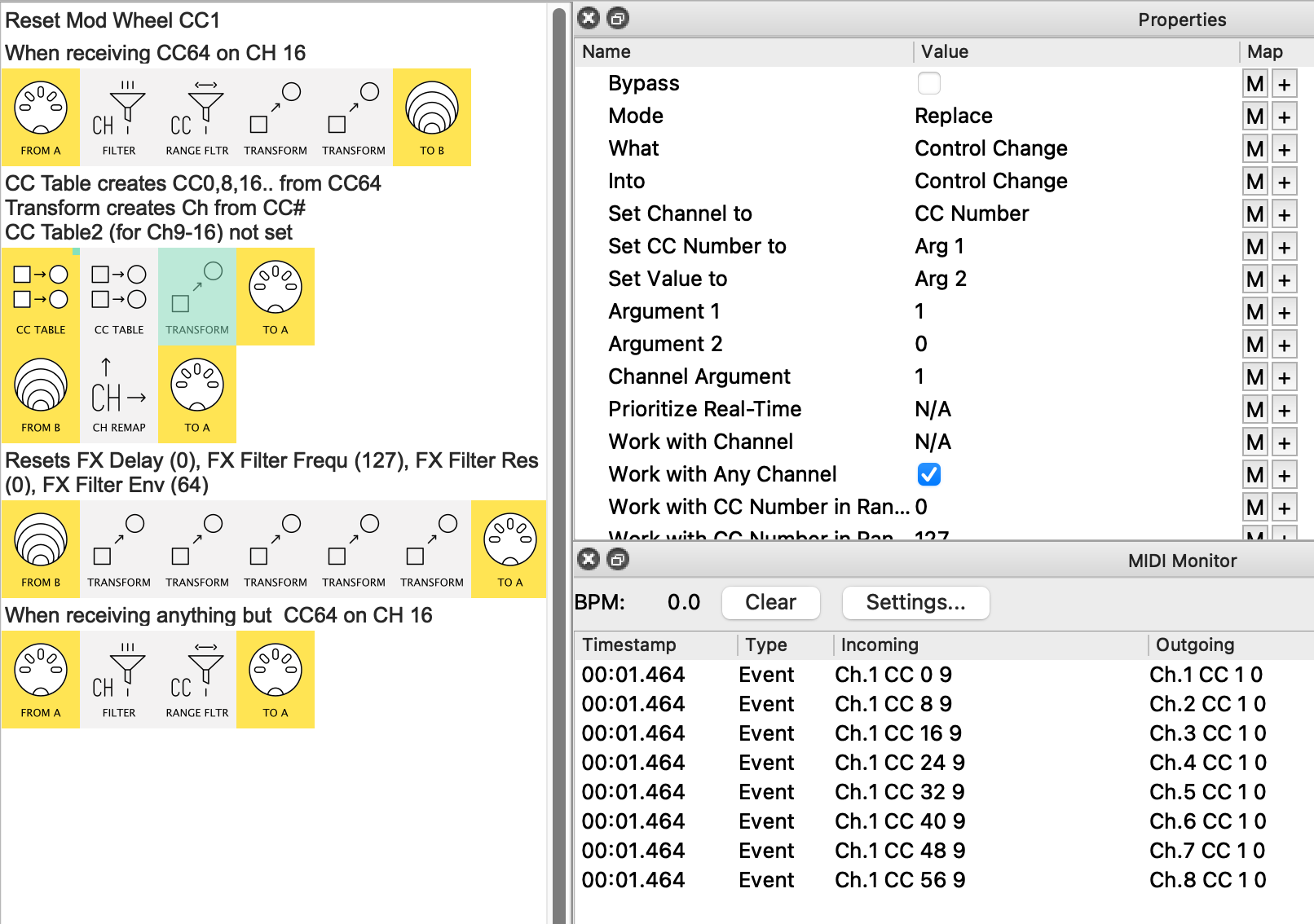

The Special Transform…
…pipe then completes the task:
It takes the CC# we’ve just created and uses that to make the correct Channel number.
(We use the Arguments to set both the id and value – as you’ve done in your original line 1)

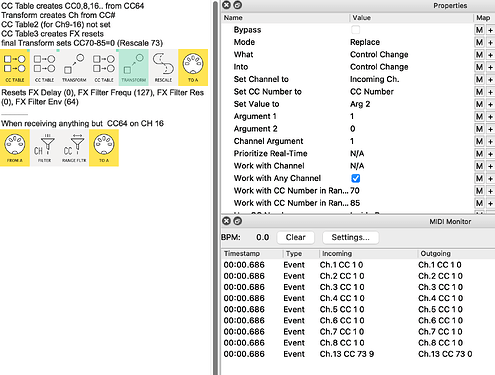

here’s that preset (Syntakt1.1.mhp – with unfinished CC Table2)…

replacing the FX line
It looks like the same Virtual B CC that resets the CC#1’s also triggers the FX resets on Ch13.
If this is true, that line can be incorporated too:

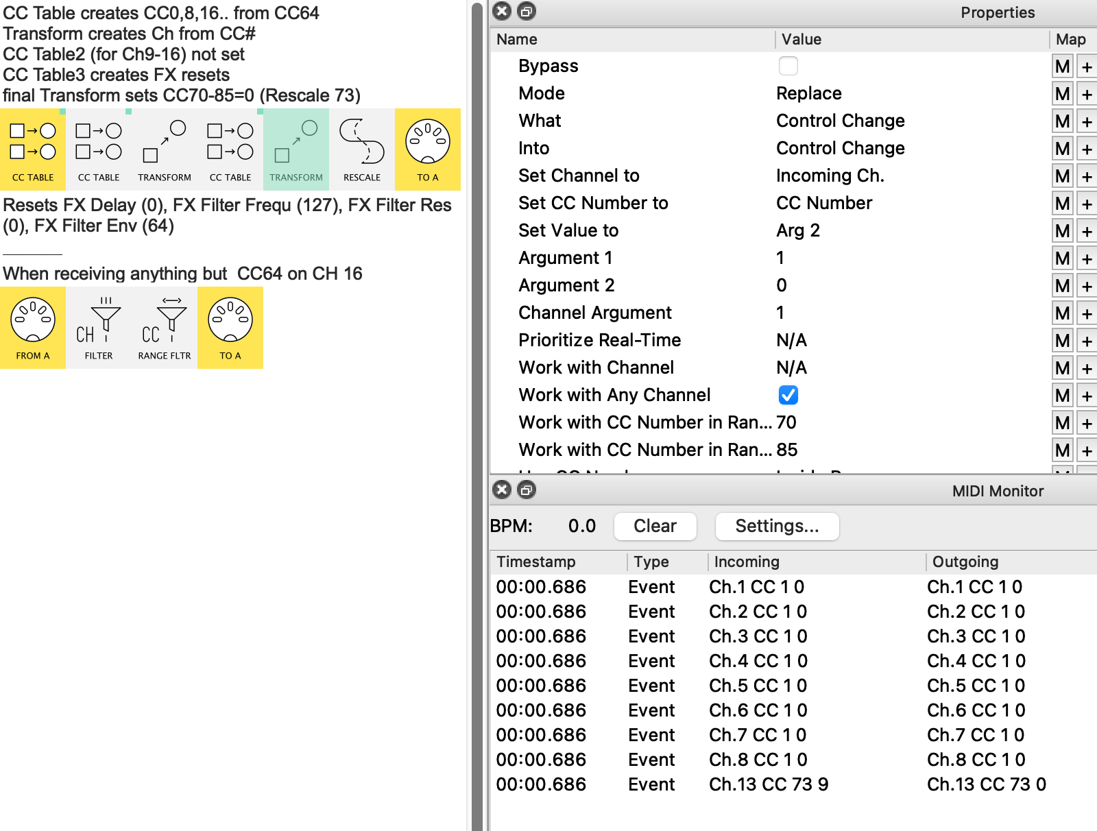

we use the same mapping to create the FX reset CCs in a 3rd CC Table.
The selected Transform replaces the CCs 70-85 with zero values
(see the last Monitor line ~ I’ve set just one of the CCs as a demo)

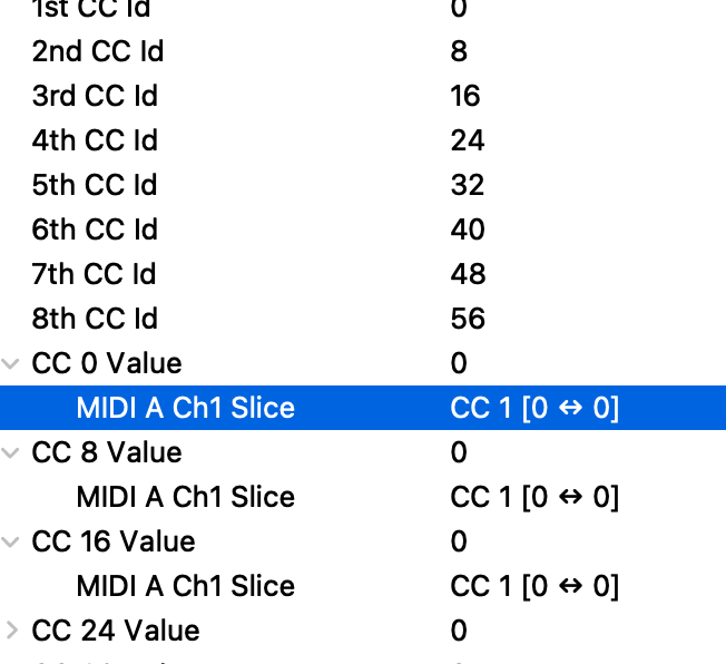

Below is a shot when I thought CC1 was coming in direct
The Slice Mode for the new mappings allows us to set them to only respond to certain value ranges.
This may or may not be useful if you only want to reset for a single CC64 value

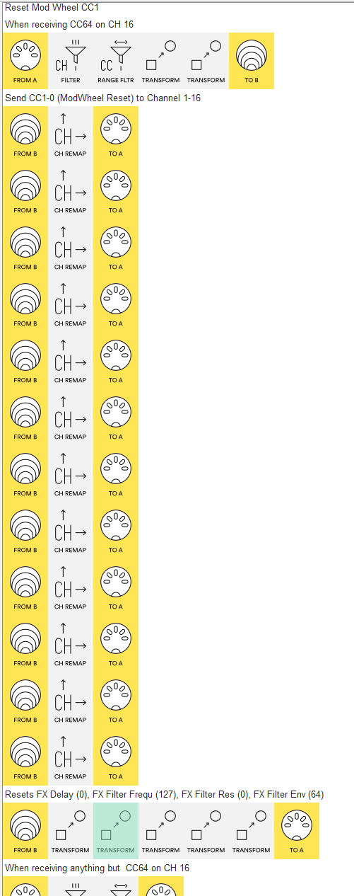

In short, 1.16 may reduce your preset to just two lines
