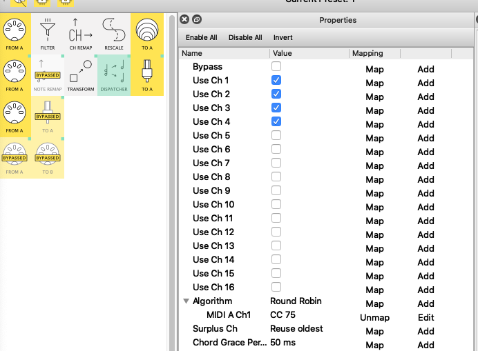

Can Dispatcher/round robin effect incoming CC messages as well as note on/off?
As my instruments are controlled by my various continuous controller live inputs, these would have to be moved to the new midi channel along with the note on/off. Is this possible?
Peter
Dispatcher in all its modes works on notes only.
One can always Transform CC → Note_on (and a Note_off After it) then Transform back → CC on the other side of the Dispatcher.
Or if you need the CCs to be sent to all channels all the time, duplicate them for the channels in use by using Transform pipes.
This can result in a lot of MIDI events produced at a time, that’s why the Dispatcher doesn’t do it itself.

Dispatcher is triggered by pressing cc 75, and I want to round robin between the first for midi channels.

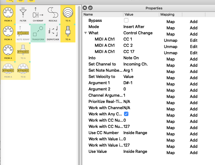

Transform is a complicated pipe to understand. Following your directions, I am trying to convert cc’s one, two, &17, to note ons. Midi monitor does not confirm that I am succeeding in this.
& Where would I put the conversion to note off?
And how would the instance of transform after the dispatcher know what note off to turn back into cc s?

Looking at your second screenshot, I suspect this is true:
Depending on the value of CC 1,2 or 17 (on MIDI A Ch1) you will find your What changing between the 15/16 different message types you’ll see in that list.
(Try it and See!)
This is almost certainly not what you want!
So we need to be clear about what you do want:
Let’s say you send in CC1value=6, CC1value=4, etc.
(Abbreviating, say this exact sequence of messages:
CC1=6, CC1=5, CC2=8, CC17=0, CC1=4, CC17=1,CC2=12,)
then CC → Notes → Dispatcher –> CC would give this:
1 2 3 4
CC1=6 CC1=5 CC2=8 CC17=0
CC1=4 CC17=1 CC2=12
(here I’m assuming the 4 Channels in your Dispatcher)
is this what you want? maybe not…
…OR
do you want this:
1 2 3 4
CC1=6 .. .. ..
CC1=5 .. .. ..
.. CC2=8 CC17=0 ..
CC1=4 .. CC17=1 ..
.. CC2=12 ..
This (fixing a channel for each CCid) would be done using just Transforms.
Give us an example...
the table above is made by typing in
| 1 | 2 | 3 | 4|
|CC1=6| ..| ..|.. |
|CC1=5| .. |.. | ..|
|..| CC2=8| CC17=0|.. |
|CC1=4|..  |  CC17=1|.. |
|..|CC2=12| ..|
… and we’ll hopefully be able to guide you.
