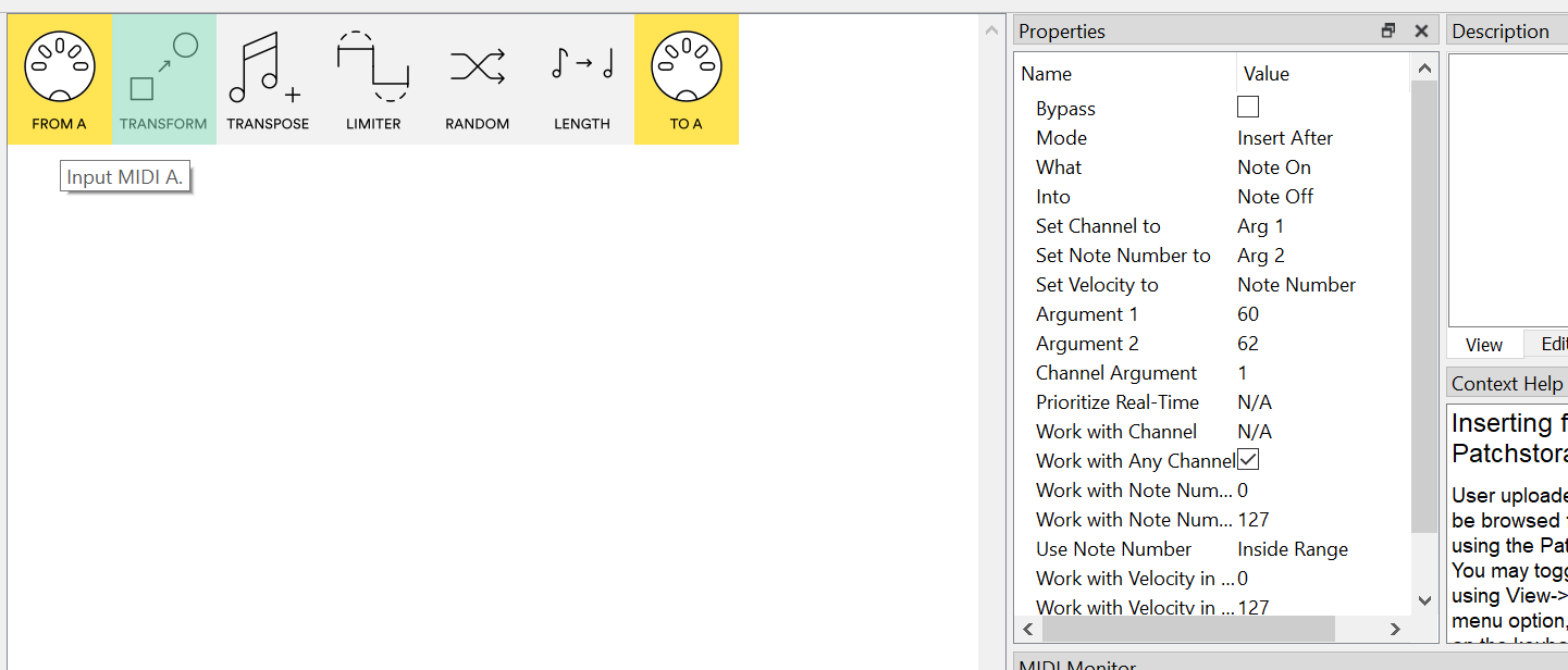

Good afternoon, how are you all? I wanted to ask you something. I have a Korg SQ1, which sends a signal to the MIDI Hub, and the MIDI Hub goes to the Behringer Neutron (to make it sound like a pad). From the Korg AQ1’s sequence, I’d like to play certain notes, not all of them. I tried it, but I don’t think it turned out quite right. Here’s what I did.
Thank you in advance. Best regards

Have you tried using the Chance pipe? It randomly drops MIDI notes based on chance and timing.
Alternatively, you can use a Dispatcher, Channel Filter and Channel Remap pipes to have a defined ‘skip’ sequence of up to 16 steps.
