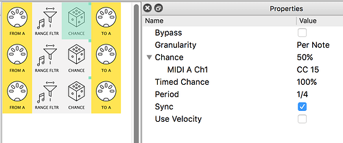

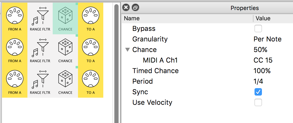

As a starter, why not try using your CC knobs on the KS37 to map them to Chance pipes in 3/4 lines:
No virtual mappings needed and you get to play around with the sort of %'s that drop enough notes to add a bit of variety without making the pattern sound too lumpy.
