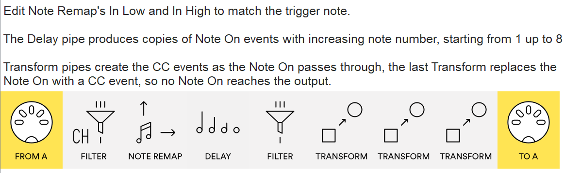

Check this out:
Note to CC Sequence.mhp (710 Bytes)
Change [TO A] to [TO D] :slight_smile:
