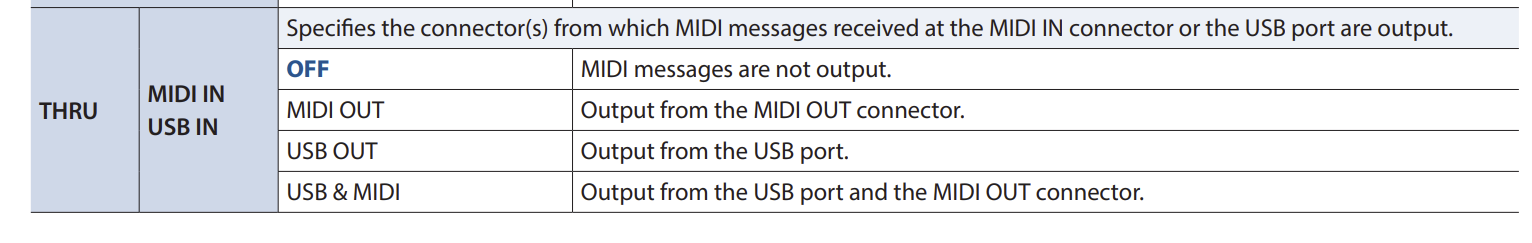

Hey, I think you have a physical loopback in your chain, the RC600 is sending incoming messages to its output as THRU. You probably can disable the MIDI THRU function in its settings:
Image from page 31 of Parameter Guide.
