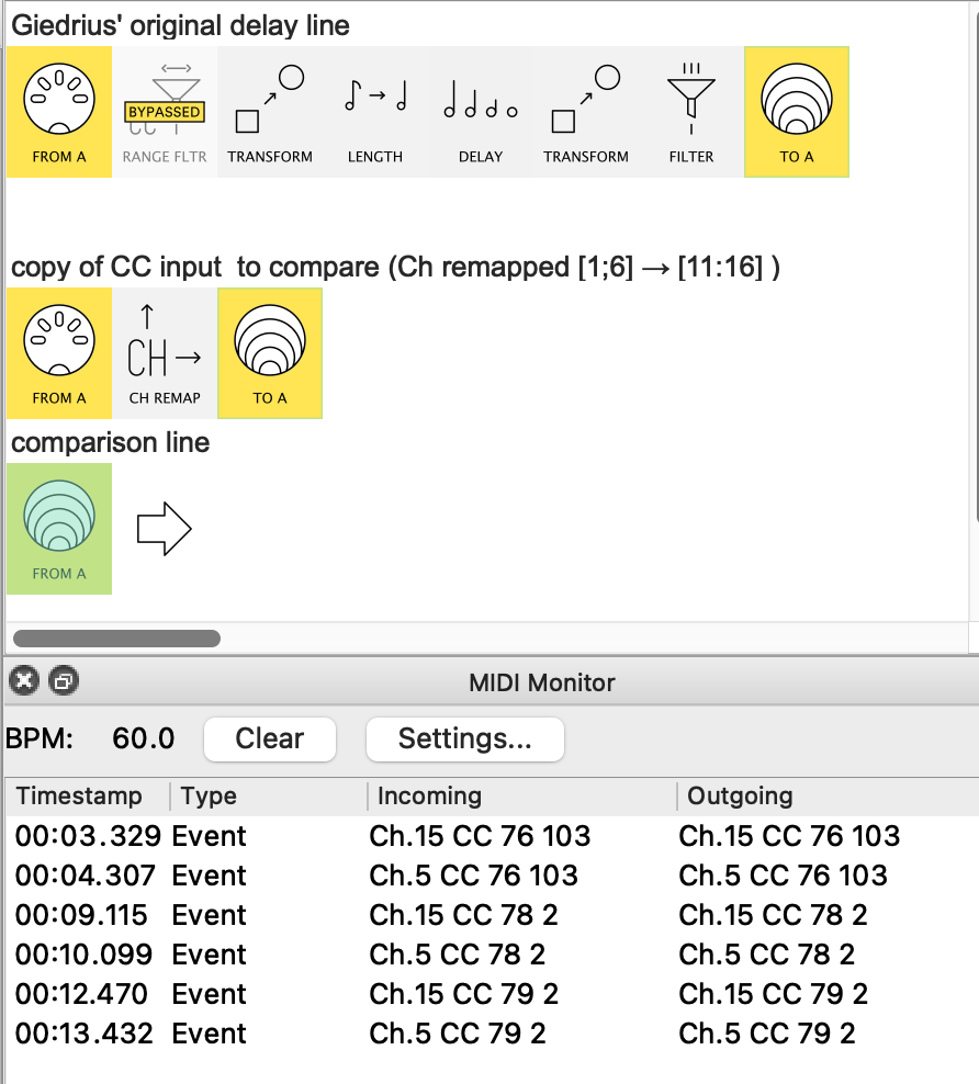

as well as seeing a stream of Clock messages, you should see the BPM like here:
(When they get annoying you can click the Settings.. button and Filter out the Clocks from the Monitor view – as I’ve done here)

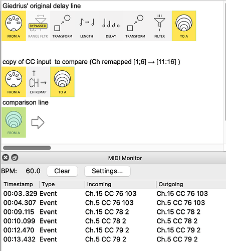

Giedrius’ preset works when adjusted for Synced Delay
In the shot above, you can see the Monitor also showing my Ch.5 CCs – with the originals remapped to Ch.15 for comparison. As you can see, the CCs are delayed by about a second @60BPM.
This is my testing preset, set to 1/4 note
