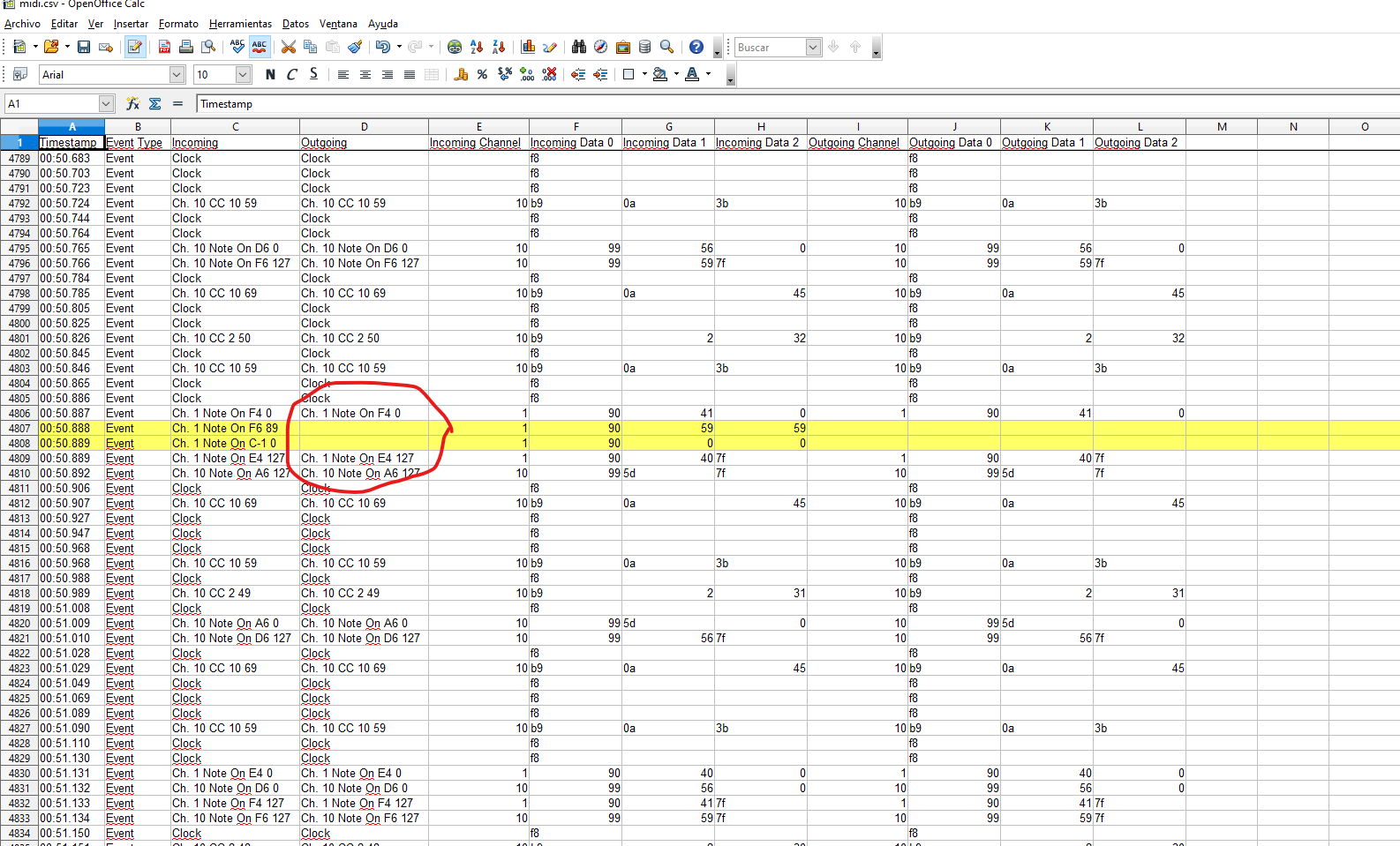

So, every now and then, I get ghost sustained notes, that only stop when I send a note off command (double stop in the Octatrack). I have detected it happening in both Virus and Mc101 (Out ports B and C). It’s really random, I double checked it’s not coming from the Octatrack sequencer. And it was difficult to detect, because it’s not very common, but I managed to grab it in the monitor. In this case the log comes from the “To C” of second pipe in the preset (which I attach, together with the CSV). I don’t use any USB pipe, btw.
As you can see in the screenshot, suddenly out of nowhere a F6 note and C-1 note are triggered (apparently coming from the Octatrack), but the weird stuff is that they are not producing any output (but they are actually sending the sustained infinite note). There’s no other row in the log with the empty outgoing cell.
I’m using firmware 1.16.0 (not the last one) and last editor. I could update, but wanted to check here first.
Any help? I’m not sure the issue comes from the Midihub, but it’s pretty annoying! thanks!

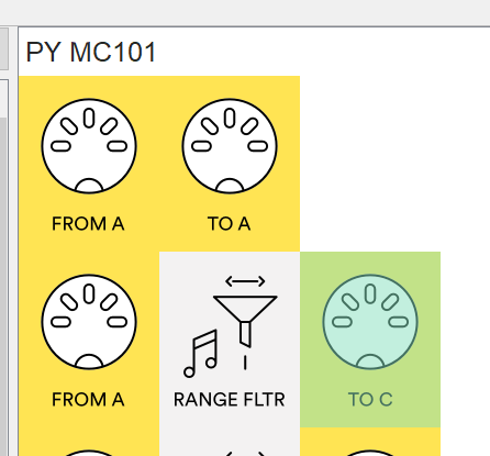

Do you mean the monitored log is from this position in the preset?
Please update the Midihub and the Editor to the latest version, and see if you can reproduce the issue. Try also to find a minimal preset required to reproduce the issue - like remove the pipelines for devices that never participate in this, etc…
Thanks @Giedrius ! I have updated the firmware and it happened once. However after rebooting the Octatrack it hasn’t happened again… let’s see.

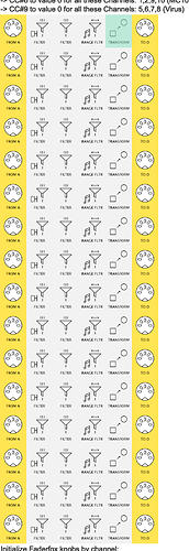

I also wanted to ask, could you help making my preset simpler? I have two big blocks that I’m pretty sure can be done in one or two pipelines. I have organised the preset to attach it here, the main blocks I’m talking about are these two:
Initialize Faderfox all knobs to 0 with one note:
When Note G9 is played in Channel 9, set:
→ CC#3 to value 0 for all these Channels: 1,2,5,6,7,8,9, 10 (Virus and MC101)
→ CC#6 to value 0 for all these Channels: 1,2,9,10 (MC101)
→ CC#9 to value 0 for all these Channels: 5,6,7,8 (Virus)
Initialize Faderfox knobs by channel:
When note F#9 is played in:
→ Channels 1,2,9,10 → Set CC#3 and CC#6 to value 0 for corresponding Channel (MC101)
→ Channels 5,6,7,8 → Set CC#3 and CC#9 to value 0 for corresponding Channel (Virus)
I have set one pipeline for every condition explained above, but I’m sure it’s much simpler. As I said, I’m attaching the preset here

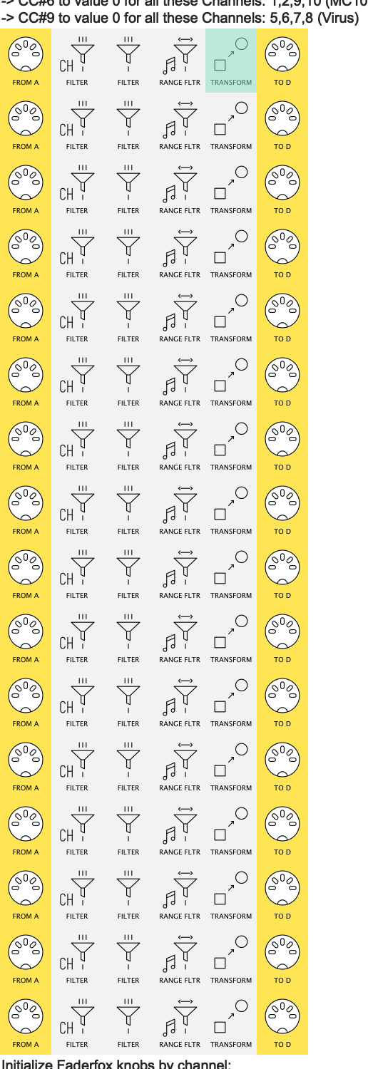

On this point @DiegoC, yes you can make this much simpler by making use of Transform’s Ranges
This block…
…for example, can be replaced by one line.
I’ll upload an example of the first few lines, then answer the other question about monitoring all lines when I’ve taken a closer look at your pipelines

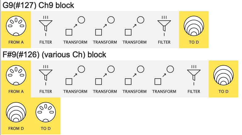

OK, this is not the most compact way :one: to go, but it might be the easiest to adapt from your current preset:
here we have the (unfinished )replacements for your two Initialize blocks
(3 Transforms from G9 block, 4 from F#9 block)
DiegoC_simplificar_ejemplo.mhp
changes to make
in each Transform, I’ve made use of Transform’s Ranges to make sure a given Transform only acts on the Channel & Note you want.
This means that, instead of being Replaced, as the note goes along the pipeline it creates the required CCs. (the final filter discards the Note)
So as you drag :two: the old pipes acoss to the new line this is what you change:
  1. Replace → Insert Before (or Insert After – it doesn’t matter)
  2. Work with Any Channel is unchecked and Work with Channel is set to the required incoming channel
  3. Work with Note Number in Range ... values to set required note
:two: it might be best to:
  • do File → Append From File… to place my pipelines in your preset
  • drag the lines to the matching block
  • copy (alt-drag) the old Transforms across one by one and modify
  • delete the old line
or start from scratch!
monitoring in one place
Obviously, this is made easier already with just two lines…
…but notice my example uses Virtual D as the Output
..then has a Virtual D → MIDI D pipeline
This gives us the option of
  1. Monitoring each “Init Line” by itself and
  2. Monitoring the output of both together

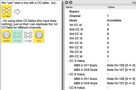

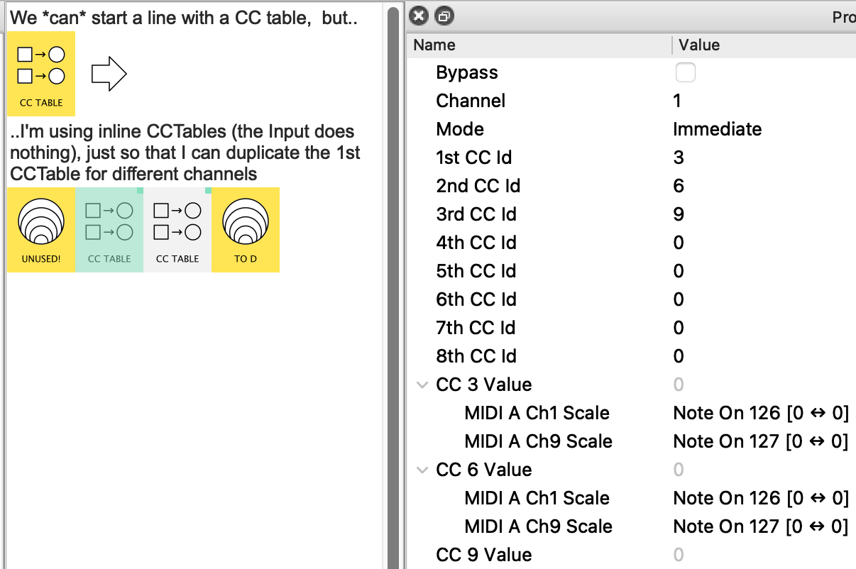

Here is the seed of a CC Table preset just so you can see:
DiegoC_CCTable_ejemplo.mhp
Here's how it works:
Instead of your F#9, G9 being used as messages, in CC Table they are used as mappings
(F#9 = Note126, G9 = Note127).
In detail:
  • the 1st CC Table is Ch.1
  • the CC3 value is set by MIDI A Ch9 Note 127 (=G9)†
    and by MIDI A Ch9 Note 126 (=F#9)
  • See that every mapping has the Range [0 ↔ 0].
    This means that, no matter what the incoming velocity is, the mapping will output 0 as required
  • Once I have set up on CCTable, I can shift-alt-drag it to make a copy for the next channel (complete with mappings)…
    …and then edit those maps which need correcting
† I don’t use Note Names with mappings because there is a currently glitch in the way they display.

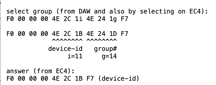

Another question! :smiley: With the last upgrade, Faderfox enabled the option to select group (i.e- preset) sending a Sysex command (there’s no other option, only manually so far). AFAIK the Midihub cannot handle Sysex commands, right? is there any workaround? this is the sysex documentation:

And No, MH only filters Sysex at present.
