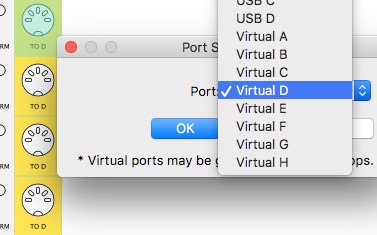

First answer: Yes it should be possible to monitor all the output in one or maybe two places by using Virtual outputs
Here's How:

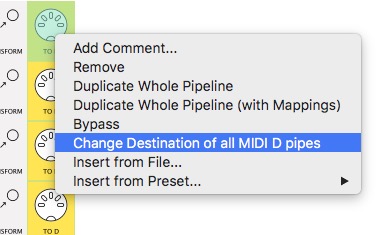

Change every MIDI-D-OUT → Virtual D-OUT:
giving:

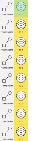

Do the same for MIDI-C-OUT:
Create Virtual IN → MIDI OUTs…
…so your preset works as before
AND you can monitor all the outputs in two places

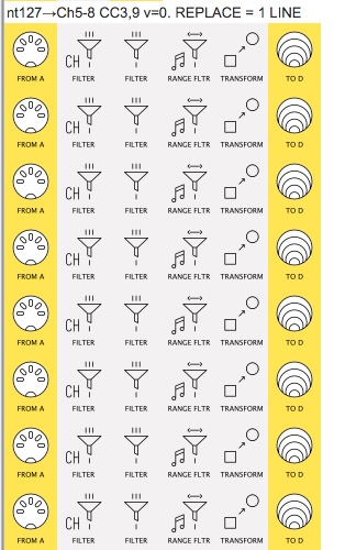

But, (2nd Answer): You can simplify the preset a lot by using Transform’s Ranges and Insert After instead of Replace.
This, for example…
…becomes one pipeline.
This will also make monitoring a lot simpler

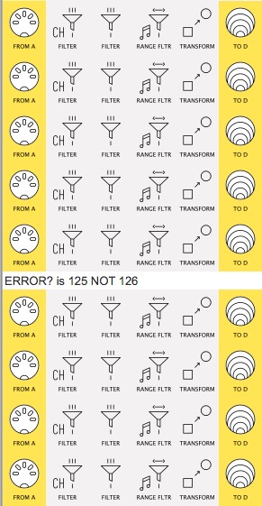

Lastly, there’s this inconsistency:
which may be your issue

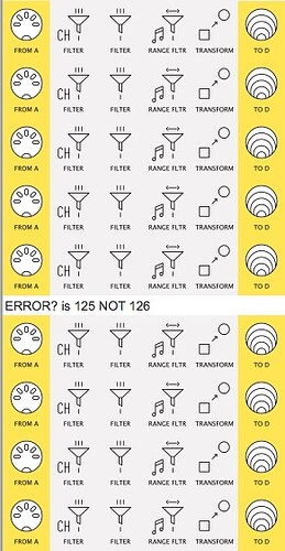

is the 126/126 inconsistency correct, btw?
sorry, which one you mean?
oh sorry, I missed the second answer… reading right now…
Oh sorry, I uploaded the old version, the newer one doesn’t have those pipes. Anyway, I don’t think that one affects, because it’s just a CC remap that is not 127, and also is not sent to Midi Out C (the one sending back to the Octatrack…) Anyway, I attach the version I have done ready for monitoring
