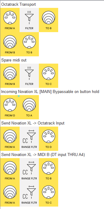

Hello I have the following midihub patch:
FROM A (Octatrack transport and clock)
TO B (Digitakt input with a THRU that goes to Analog Four)
TO C (Goes to an Analog Rytm)
FROM D (Novation Launch Control XL Incoming params)
TO D (Octatrack Input to receive CC from Novation)
TO B, TO C accordingly.
The idea is to have Novation control everything via midihub’s magic but keep the clock and transport from the Octatrack.
Now my problem is that when I do something quick with the Novation fader it will slow the clock down for all the devices
(Edit: When I monitor FROM A or FROM D while the tempo drifts when violently moving the fader I see no overflow messages)
DICHOTIC-MAIN-1.mhp (678 Bytes)
