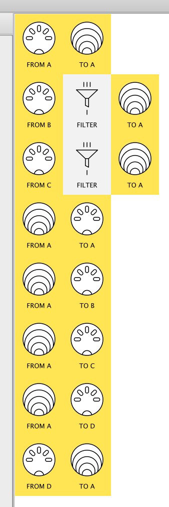

On a simple preset (only midi to midi) it starts blinking slowly too, but it’s harder to get to that point. On the preset that I use it’s easier to get it to blink slowly. I attached my preset.
