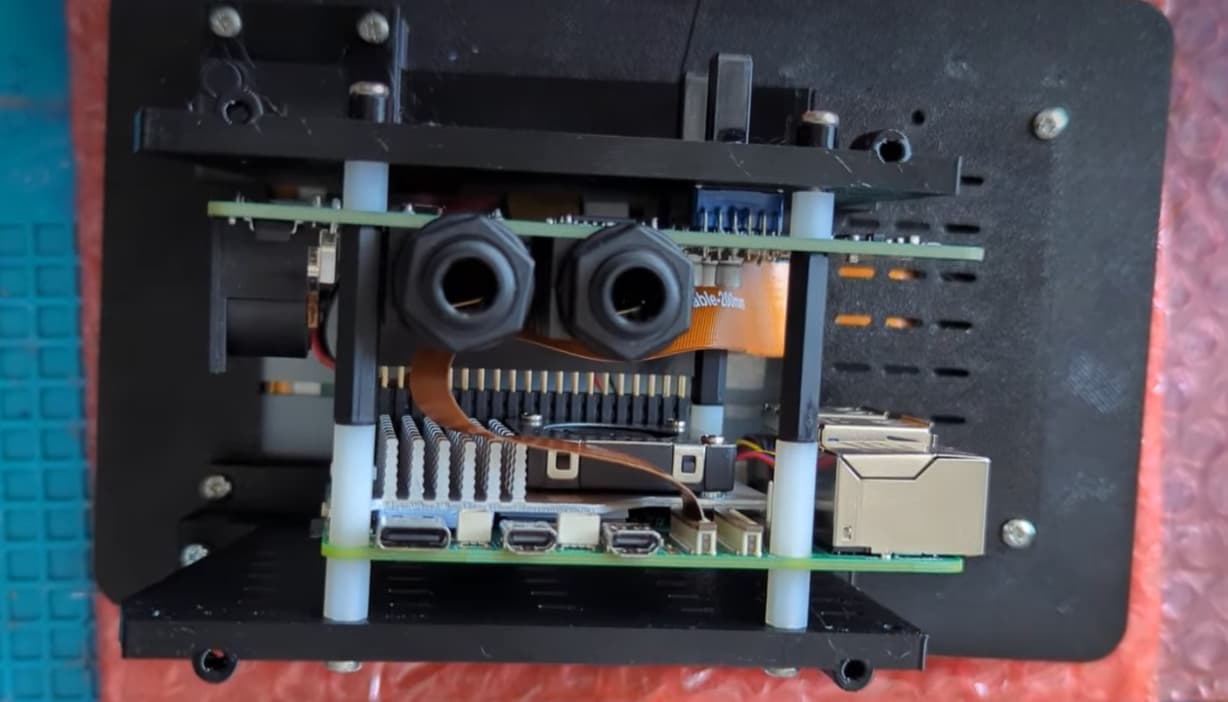

As someone who owns a Pi5, Pisound and Pisound case, your best option for keeping the Pi cool is the official active cooler. It works perfectly with all the above as long as you have the latest version of Pisound and case.
OK … does all of that fit together? If there are spacers / standoffs required, are they included?
Yes, the Pisound case fits very nicely with the latest Pisound, Pi5, active cooler and case. I started off with the older Pisound and a Pi4. Last year I upgraded to a Pi5 with the new Pisound, active cooler and case. Love it!
Here’s a link to the page that shows how the Pisound case is assembled and it does come with all the required standoffs.

Anyway, the Pisound Acrylic Case can fit both the Pisound v1.2, and the Raspberry Pi Active fan, retaining the same height as originally designed for the original Pisound.
Thanks for the clarification. I ordered your case. Please if possible send in same box w pisound card. I don’t need anything else.. like spacers ?
All the necessary parts are included with Pisound and the Acrylic Case to assemble it.

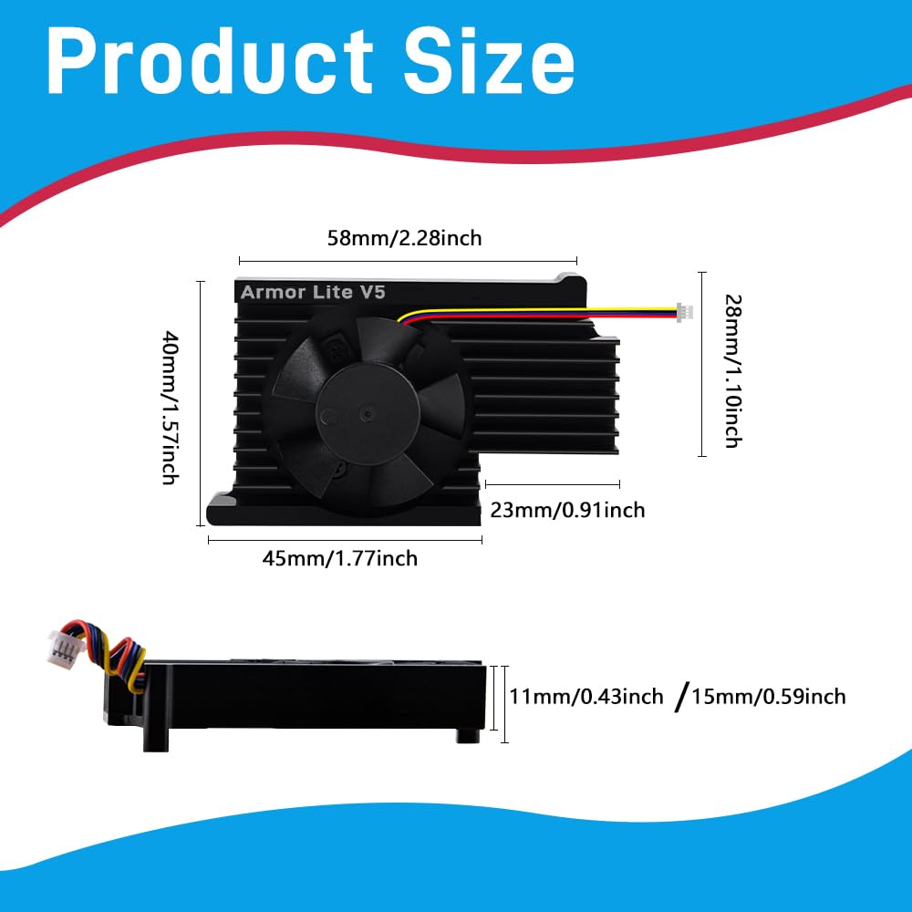

Just installed the active cooler from GeeekPi (Active Cooler for Raspberry Pi 5 - Armor Lite V5) but PiSound Jacks phisically stop the fan. Maybe I have to keep the PCB higher. Or do you think it would be better to use another Cooler?
I would certainly suggest the official active cooler from raspberry pi. That’s what Blokas used when they designed the newer Pisound and case.
From Drawing the Official one is 14mm height.
If you look at the official cooler drawing it’s 13.7mm for the fastener. So I would assume the height of the cooler is less than that. The drawing for the one above is 15mm. So it’s a bit higher than the official cooler.
Yes, Raspberry Pi Active Cooler Fan is the recommended one, it works out of the box automatically, the speed is based on the current system load and temperature.
If using an alternative fan, you might have to use slightly higher extenders. For extremely high clearance, a GPIO expander header can work to make Pisound still be able to make contact with the header pins, as can be seen in:
