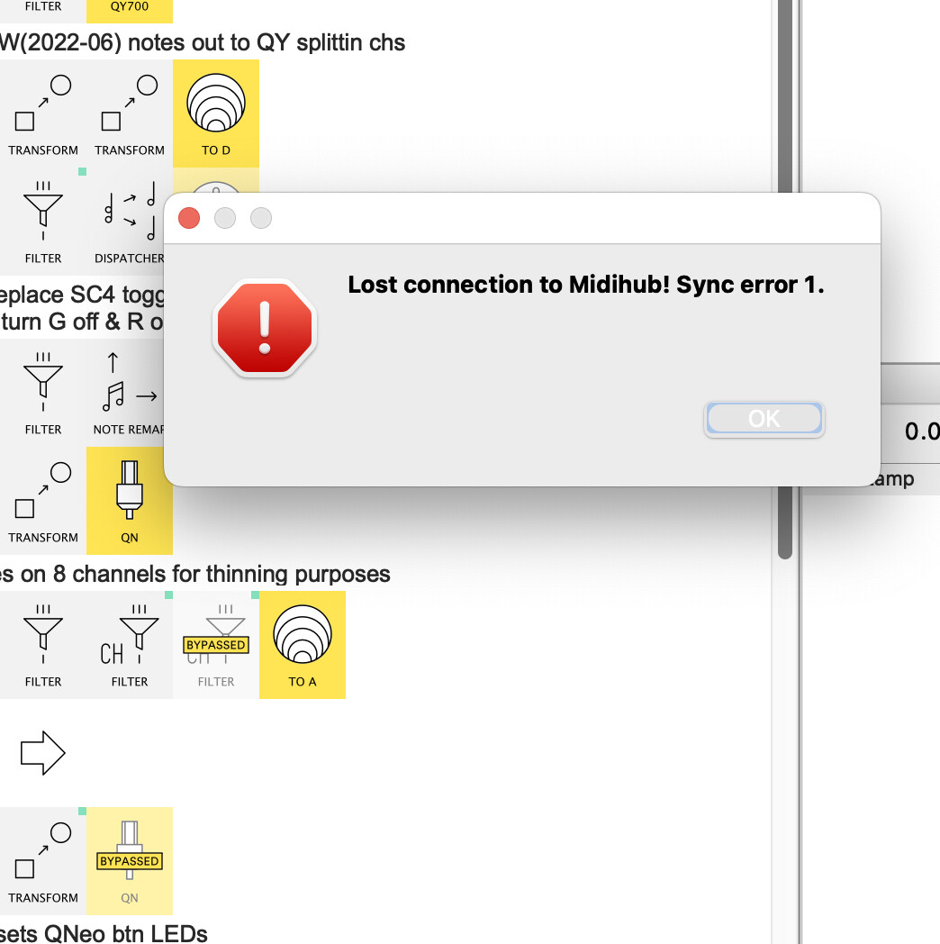

Connection lost or unexpectedly shutting down for no reason. I re-connect and everything is ok. seems a bit unreliable, what might be causing this?

Does your error message look like this?
I’ve been getting this with MacBook OS Sequoia.
Have mentioned it to @Giedrius but think it’s a newer Mac OS thing❖.
(have since found that two KMI devices get kicked back to their defaults too which is waay more annoying)
Thankfully MH keeps your current preset in flash memory, so nothing is lost, but I’ve taken to stopping Mac going to sleep/launching screensaver while I’m patching. Bloody annoying though!

Thank you, yes, I get that one, but I think there are other messages too. It happens every once in a while when I’m working in other apps. Quite often. I’ll try to “document” it better and get back.

It sounds like Mac OS is restricting CPU resources for apps running in the background more aggressively or something. The message itself occurs whenever a ‘pong’ is not heard from Midihub in set timeout time when the Editor pings it. It has no effect on Midihub’s operation, just the Editor ↔ Midihub connection gets terminated. Maybe we should just set the timeout higher.
