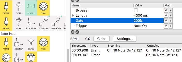

This will give you 8 sec:
(ignore the other lines :smiley:)
200% Gate is the highest you’ll get.
