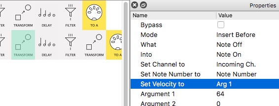

Hey @Fabi, try changing the “Note On creator” Transform in the second pipeline like this:
(this line creates an preceding Note On so that the Note Off gets delayed too.
The edit just gives the Note On a velocity so it gets through the 2nd Filter)
Thank you so much, I can’t believe this has actually fixed it. I spent so many hours trying to get this pipe to work. You saved my day + many days to come :slight_smile:
