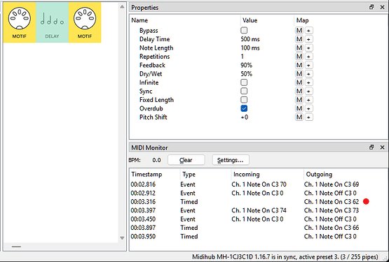

Good evening,
I also get hanging notes from the Delay Pipe. When repeating an incoming Note On close to when a Timed Note On is sent out, for some reason the Note Off corresponding to that Timed Note is missing.
Thank you for the report, I’ll put looking into this in my work queue. :slight_smile:
