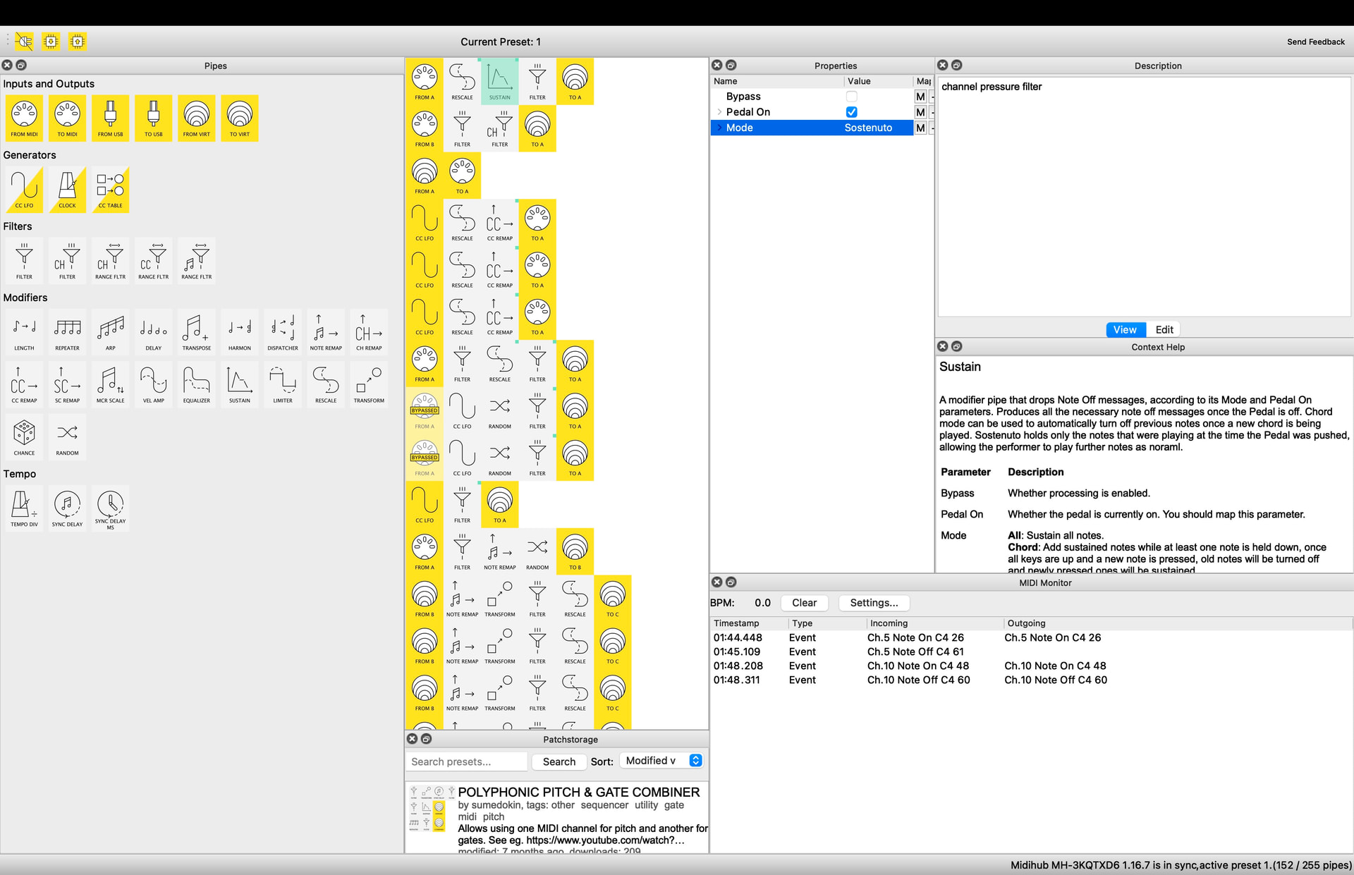

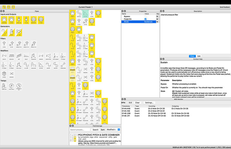

Can you send me some MIDI monitor screenshots showing what’s your input, what outputs you get, and what’s the expectations?
One obvious way to fix it would be to remap all channels to a single channel, if the receiving device does not require using different channels.
Hopefully you can see the note has come through on a different midi channel, which means that the note off message leaks through. I was trying to think if there was a workaround using a filter in some way, but I haven’t come up with anything. It needs a dynamic note filter or something so that you could then collapse the latched notes to a single channel. But even if that worked you’d have to run parallel pipes for the latched notes and the played notes, each with filters.
