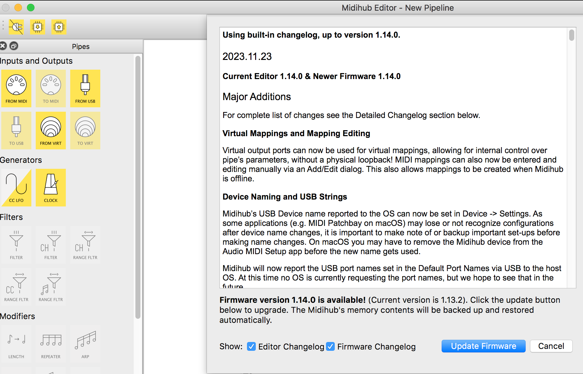

  1. confirm You see Sostenuto Mode in your version:
    if not,you may only have the new Editor but have not clicked to upgrade the firmware too
    (the option appears when you click Connect…)

You are correct- somehow I did not update the MidiHub. When I click connect, I do not see any option to update firmware. Where exactly would it be?

I can’t even update the firmware. I seem to have missed the opportunity when I updated the editor. I cannot get to the information page that has the firmware update button.
I had that same issue with not seeing an option for a firmware update. The editor said it was updated but I didn’t see any of the newly added options. I completely uninstalled the editor and reinstalled the new beta. The option to update the firmware appeared at the first startup.
Try going through the ports to make sure you aren’t connected to the wrong end accidently. If Midihub is blinking but not seeing any midi messages. What model pedal do you have specifically?
Maybe you have already updated? What version do you see displayed at the bottom right of the Editor’s window, when Midihub is connected?

it says 1.1 4.0
That is why I thought I had updated.
But there is no sostenuto option in my sustain tool. only “chord”
Make sure you’re running Midihub Editor 1.14.0 - Help → About Midihub Editor (or Midihub Editor → About on macOS) should say it’s 1.14.0.
