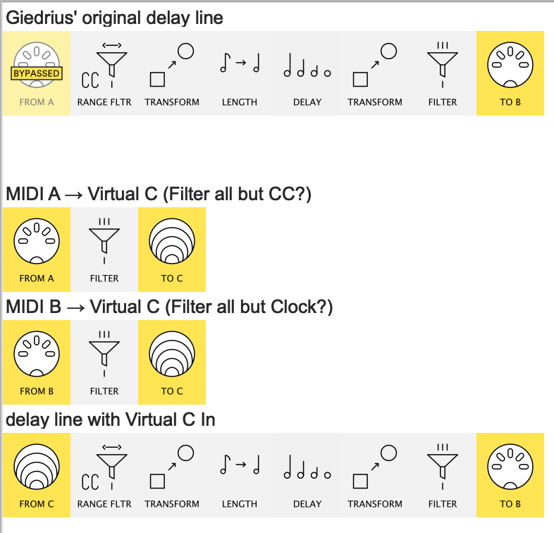

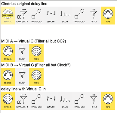

External Clock through multiple pipes
Use virtual pipes in combination with Filters to get precisely the messages you want flowing through the CC Delay pipeline:
Virtual pipes are essential for merging and splitting
