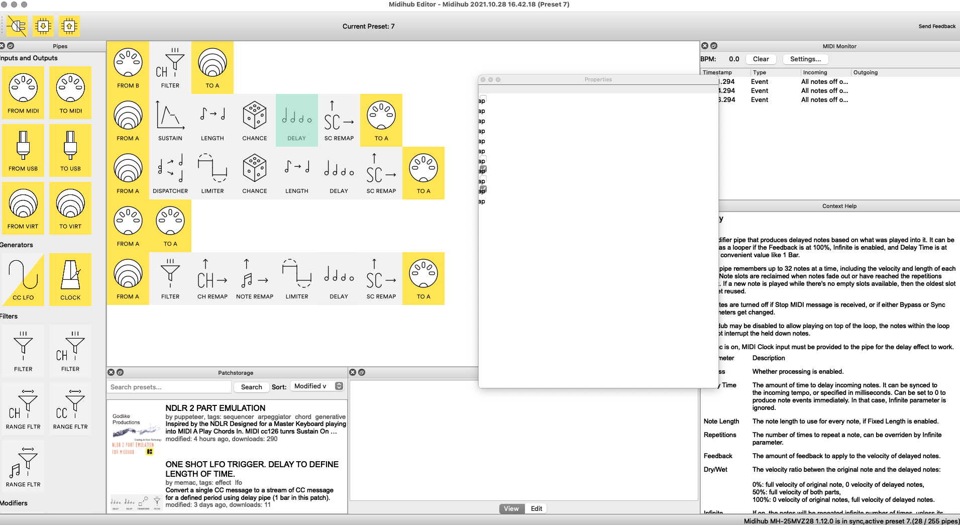

Hello I have a bug in the display of the properties panel. Can you help me correct this problem?
Hi, please see my reply here on how to get it fixed: Weird Properties Glitch in Editor - #8 by Giedrius
Before you delete the plist file, I’d appreciate it if you could send your current file to me, so I can reproduce it and make the Editor sort itself out whenever this occurs. :slight_smile:
Hi Gedrius thank you for your Help : here is the file… I can delete it so …!
com.blokas.midihub-editor.plist.zip (10.5 KB)
Thank you, yes, you may delete it now, make sure to do it while Midihub Editor is not running. :slight_smile:
Gedrius, thank for help : everything is in order, problem solved.
