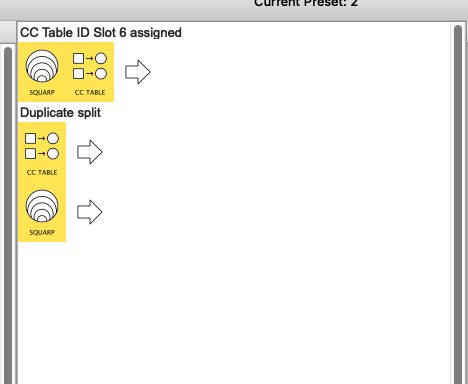

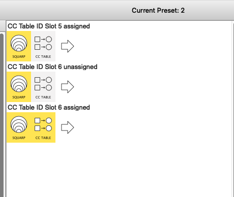

There appears to be a bug with CC Table ID Slot #6. When assigning an ID to this slot with CC Table as a modifier, the pipe turns yellow as if it is a generator. The bigger problem is when deleting the pipe or pipeline after it’s been saved, the editor crashes and I’m not able to delete the CC Table pipe/pipeline. It does not exhibit this behavior when assigning slots 1-5, 7 & 8. Also, when duplicating the pipeline, the duplicate PL splits and the CC Table modifier becomes a generator.

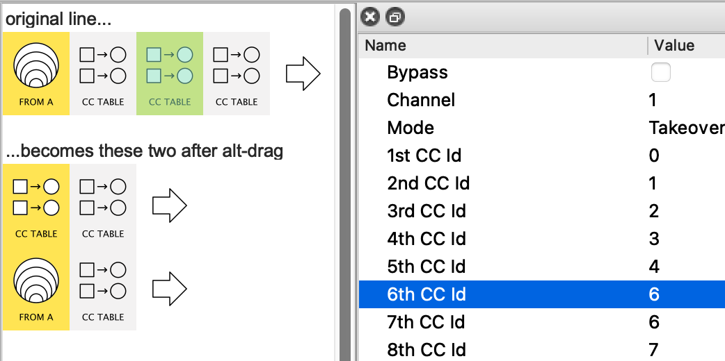

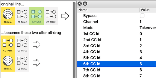

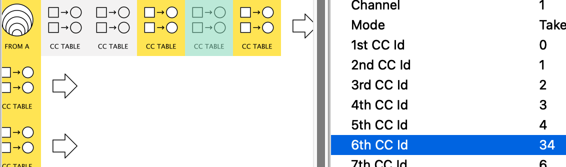

Behaviour is as if setting 6th CC Id creates two+ pipelines in one (alt-drag of line with two yellow CC Tables creates three new lines)
Also alt-dragging of yellow CC Table in-line returns the faulty yellow CC Table to a white one…
…but also creates a new in-line generator.
(changing 6th CC Id → 5 doesn’t rectify)
