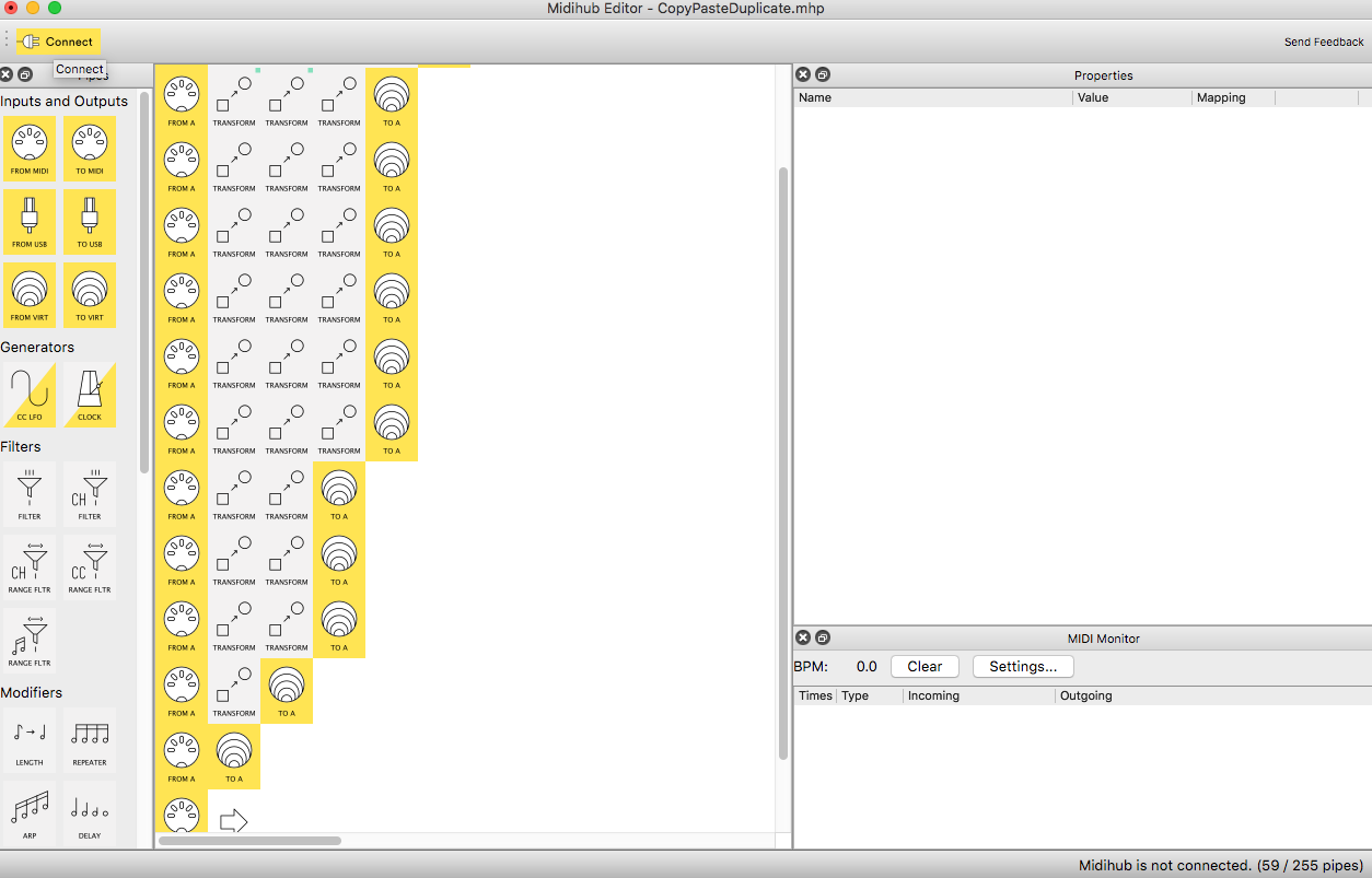

Here dragging (from the file above in the 1st Editor) caused inconsistencies:
Original Transforms
L1: (Note_on,Inside), (Note_on,Outside), (CC,Inside),
L2: (Note_on,Inside), (Note_on,Outside), (CC,Inside), (Note_on,Outside)
L3: As L1
(L2&3 created by [shift]-alt-dragging L1. All as expected)
1st attempt dragging to new file
CopyPasteDuplicatedToSepEditor.mhp
screenshot (source below, destination above):
  • L1: alt-drag Original L1: loses Transform1
    becomes (Note_on,Outside), (CC,Inside)
  • L2: shift-alt-drag Original L1: Barmy!
    (Note_on,Outside), (CC,Inside),(Note_on,Outside Mapped)
  • L3 shift-alt-drag Original L1:OK
  • L4 alt-drag Original L2:“OK”
    but note Mappings copied even though Shift not down

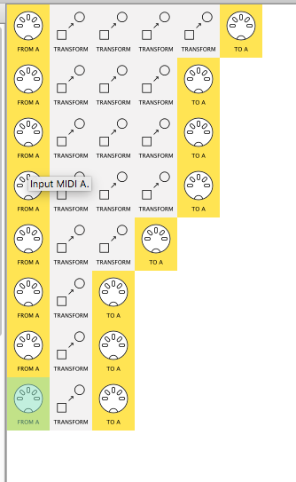

Confirmed!
when i use this file ,or just new file
even with one instance of MIDIHUB Editor ,
when i drag pipeline by the first MIDI PORT pipe while holding ALT to duplicate
after few times editor starts to cut pipes
this behaviour is inconsistent
Thank you, will be fixed in the next minor update.
