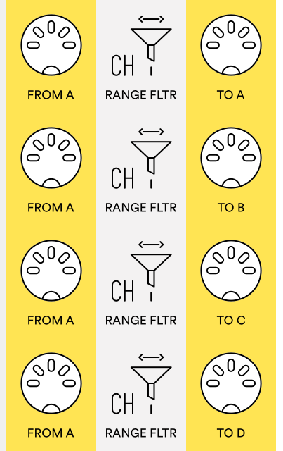

would there happen to be a template i can download already set up for a hardware sequencer ( digitakt) sending midi data from it’s midi out to 4 synths using each of the outputs?
I’m asking because i can’t really get my head around how to do this.
thanks B
Hey, you can do it like this:
One_In_Four_Out.mhp (423 Bytes)
It sends Ch. 1 to MIDI A output, Ch.2 to MIDI B output, etc… If you want this to keep all data as is, simply remove the Range Filter pipes.
For more presets, see https://patchstorage.com/platform/midihub/. Most of the time you usually have to adjust them to match the channels and ports you use in your studio.
