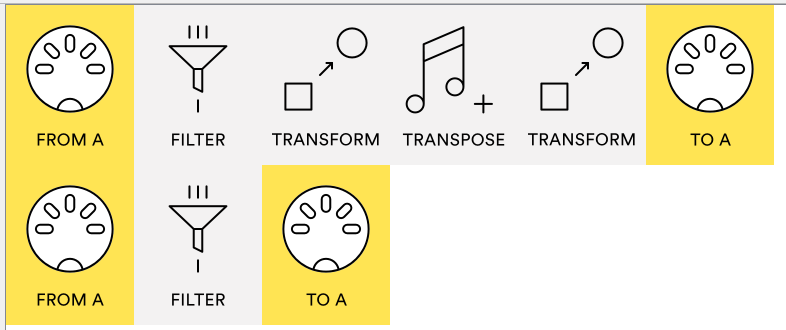

Hi, yes, that’s possible.
PolyAfterTouchMinus36.mhp (123 Bytes)
The Filter pipes are used to split the incoming MIDI stream into one containing just Poly Aftertouch messages, the other containing everything but Poly Aftertouch, forwarding them to the output. The first Transform converts Poly Aftertouch messages to Note On, then uses Transpose -36 to lower it down by 3 octaves, then another Transform converts it back into Poly Aftertouch.
