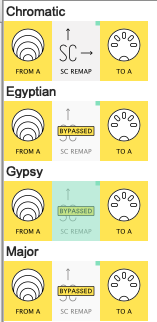

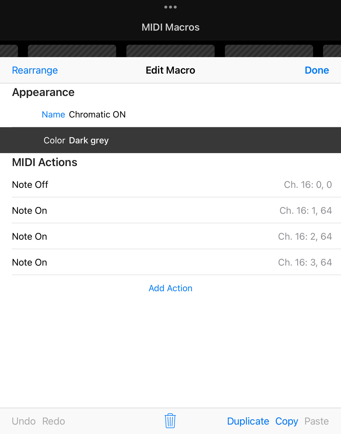

Because the SC REMAP pipeline is ‘not mapable’ I figured out a way to switch between the presets using the SCALE mode Note On & Note Off Type mapping.
In the below screenshot taken from my iOS MIDI Macros app enables the Chromatic scale (C-1 Note Off Ch. 16: 0,0) and bypasses the Egyptian (C#-1 Note On Ch. 16,64), Gypsy (D-1 Note On Ch. 16,64) and Major (D#-1 Note On Ch. 16,64) scales. Take note (no pun intended) Note ON 64 is BYPASS and Note OFF 0 is ENABLE. I love all the hard work you put into midihub, but WHYYYY?? LOL

It reflects the checkbox logic - a high value is to tick the box, a low value is to untick it. Think of it as ‘bypass on’ and ‘bypass off’.
This can be inverted by going to the advanced mapping options for the mappings and swapping the Low and High values, so they’re 127 and 0.
