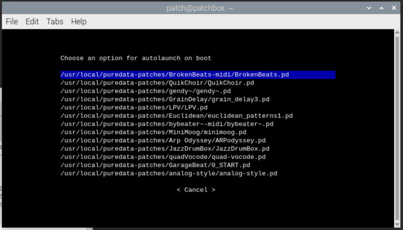

I found a way by using logincal link to wmy folder
sudo ln -s /home/patch/ /usr/local/puredata-patches/Phil/
then I copied the blokas yaml in my folder /usr/local/puredata-patches/Phil/blokas.yml
and it shows up, so I can select it in the config utility
note that one canno create a symbolic link from /usr/local/puredata-patches/, it requires a proper normal folder
also I whish there were documentation that explains where are all these puredata/pisound settings stored
You can either create a ‘blokas.yml’ file in your PD patch folder, or name the entrypoint fail as ‘main.pd’.
