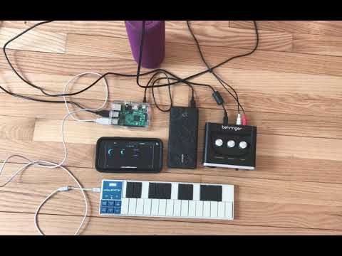

Thought I should post a video of Orac 2.0 running on rpi 3b just to show that it’s still possible in 2021. Some of the older videos make it seem outdated (based on the comment section in the vids) because of how much trouble people are having getting it running. I would say it is always user error because if you follow the instructions correctly that Mark provides it does still work. I’m not smart with the pi hacking stuff. Just started a week ago and I got it to work. If I can, you can too. Don’t give up. Thanks Mark!
