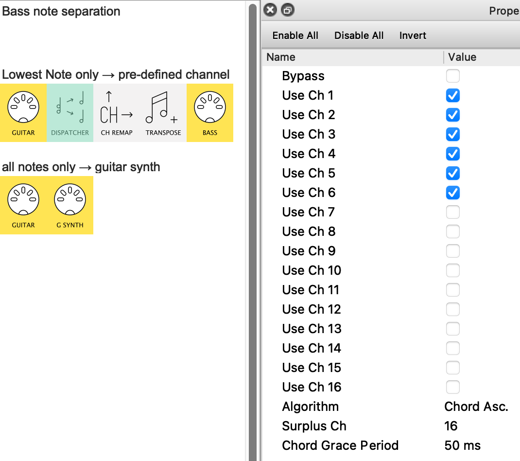

Now there are also Chord Modes:
super powerful but not written about much:
  • You would use Chord Ascending so your bass note would come out on the lowest channel selected.
  • A Channel Remap further down the line would then separate (and “re-channel”) the bass note to send it out the correct port. This would also you to independently set the Note Length if that’s useful.
  • The “guitar notes” would travel down a parallel pipeline.
  • You can have more than one Chord Dispatcher if you want to let your imagination run…
PS. check out the blurb on Chord Grace Period and think about whether this fits your playing style (it can’t select the bass note until it “knows” that the whole chord has been played!)

Hey, @Johnk,
Yeah I guessed that, which is why I added the PS about Chord Grace Period
Think also about whether you’d want Bass on all the time or “switcheable”, i.e:
  • a Midihub preset that does only that selected by Program Change
  • a pipeline within a preset that is toggled by some footswitch message
You haven’t said where the guitar notes are going, btw.
(this version has a octave-down Transpose just for fun)
Step through the pipes yourself on the Editor (no MH needed)
JohnK bassline.mhp
Better still, if you really want to think through the variations (do you want a bass “mirror” when picking single notes, for example?) the best way to be sure would be to play Jamstik into a DAW then upload the resulting .mid file.
I (or maybe someone @Blokas) can then show you what Midihub would do with it…

It does.
Exactly how well it could work in your circumstance would involve development on your side:
This, for example:
is from a midi guitar .mid file another user created & uploaded for an entirely different purpose (and one not particularly pertinent to this task❖)
TLDR
the MIDI guitar notes were sent to MH from a hardware sequencer/sound module, the bass notes created were then played back into the sound module on a different channel.
The guitar levels were dropped to accentuate the derived bass.
(The bass notes were played out at the incoming velocity, btw, but MH can modify this)
After listening once, I added an extra stage to drop highest bass notes a 2nd octave.
