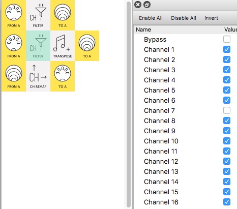

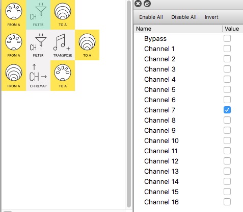

If this is a specific fixed channel, say Channel 7, then use two “parallel” pipelines each with a Channel Filter:
(I’ve merged the flows in pipeline 3 for the Channel Remap assuming you might want to do some other common processing. Yours may be simpler)
