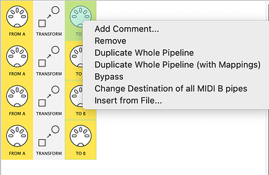

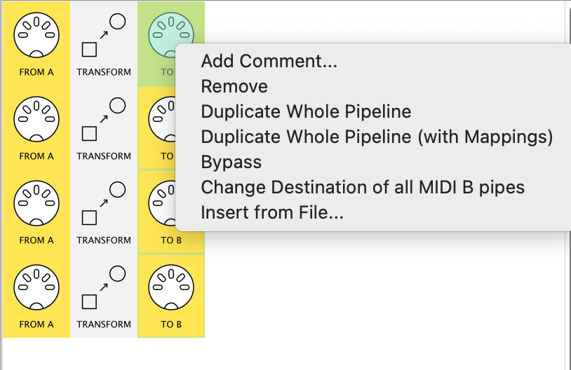

    control click gives you this menu to do them all at once!

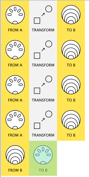

  2. …and add another pipeline to funnel all the 4 flows into just one MIDI B OUT:
  3. Now when you send the 4 PCs in you’ll likely see the problem by monitoring the MIDI B-OUT

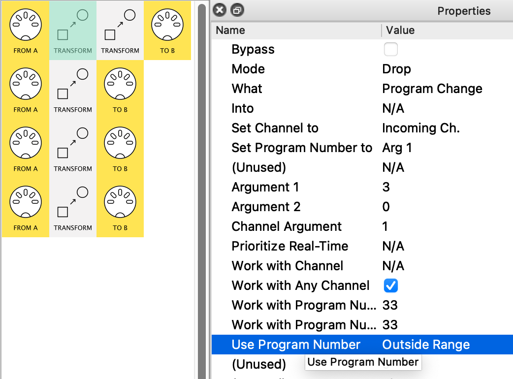

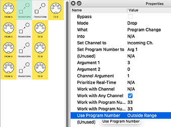

First, use option/alt-drag to make a copy of each Transform (drop it right next to the original)
Then, change the first Transform in each line like this:
  • change Use Program NumberOutside Range
  • change ModeDrop
lastly, change ModeReplace in your 2nd Transform
This means that each pipeline only lets a given PC in…
…and replaces that with the one you want

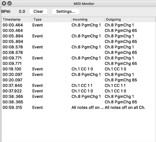

also why in this pipeline is the original PC message still being sent to outgoing? I want it not to be sent and instead to be transformed into the new PC message.
because you didn’t do this bit:
Insert After|Before adds a new message to the flow.
Replace removes the original (see tutorial here.. )
