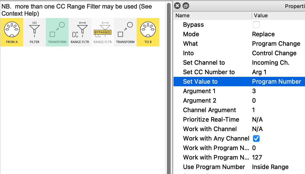

  1. PC Filter pipeline Filter (all but PCs) → (one!) Transform PC → CC (see below):
    this Transforms all PCs so that you leverage CC Range Filters to selectively remove “PCs”…
    …then a final CC → PC Transform recreates the remaining wanted messages
  2. specific PC → CC pipeline
    This is as in scenario A except here, the final filter should block PCs as they’re already going through pipeline 1
example Transform:
(the 2nd Tranform effectively does the inverse)
