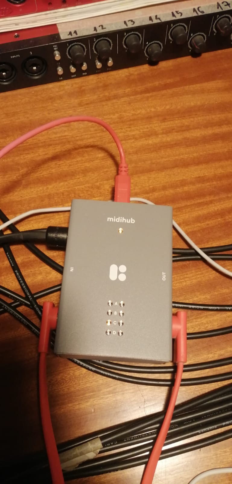

My external sequencer is sending MIDI Out to MIDI Port A of the MH. I have made a physical loop.
I’m expecting that selecting the same bank on my external sequencer will switch the preset accordingly, but when I try to switch bank both led lights of port D flash and nothing else moves.

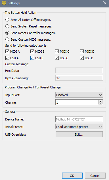

These are the current device settings. I also tried changing the Program Change setting on the port I’m using and set the MIDI
Midihub Data 2026.02.12 22.13.06.mhd (21.7 KB)
channel to 16, but unfortunately nothing has changed.
The configuration is exactly how I originally found it
Attached you can find the .mhd file. I also tried re-storing presets on the device, but PC doesn’t wanna move.
cheers!
PS: midi cable is pretty sweet for short connections → RockBoard Flat MIDI Kabel 30 cm
…I think I got it, and your suspicion turned out to be right :slight_smile: The device settings got somehow changed, and I have now set input port to D and then channel 16, and everything seems to be fine

I just reloaded my previous .mhd on the test MH and, lo & behold, it reset the Settings to as in your screenshot.
Something to make a note of …
The .mhd file is a complete backup - it contains all the presets and the device settings.

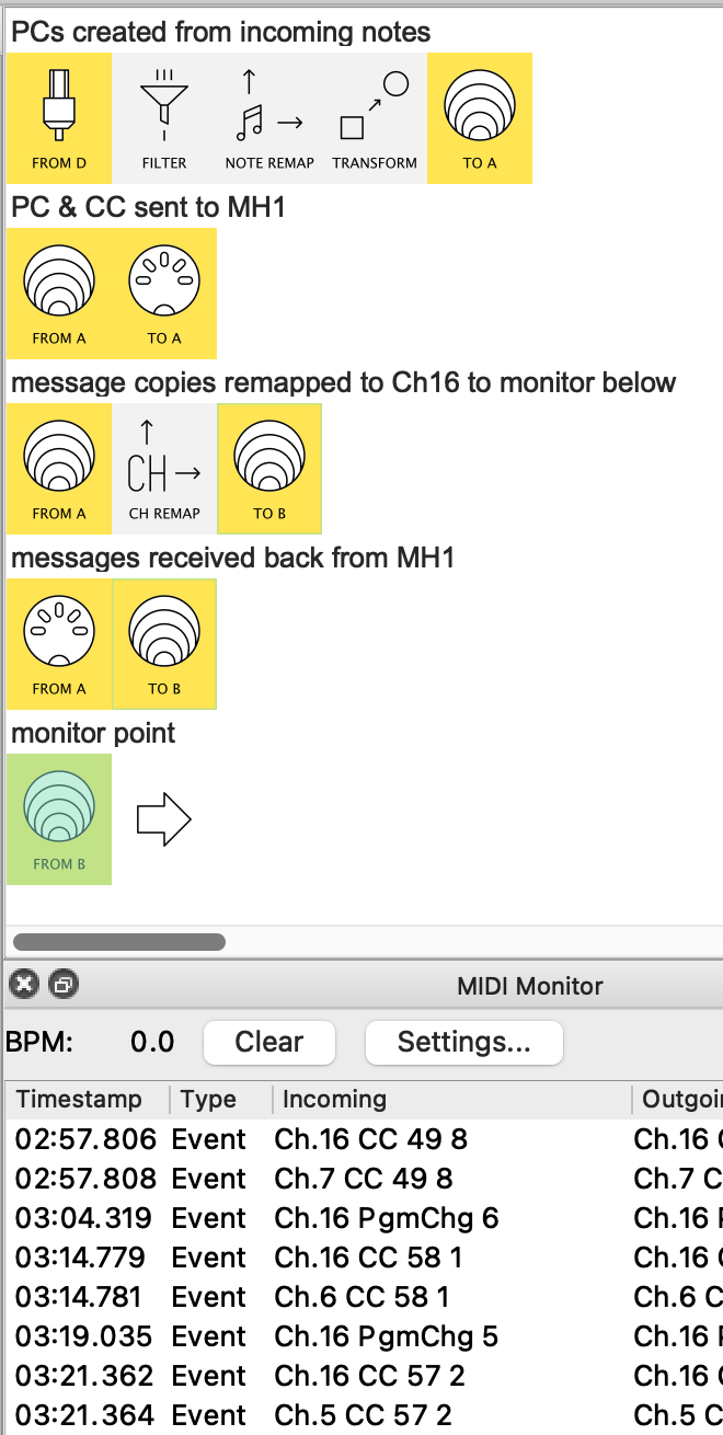

Test
here’s a test from a 2nd Midihub:
pipelines:
  1. an incoming note creates a PC
  2. this is sent to Midihub 1…
  3. but also sent to Virtual B after a Ch Remap to Ch16
  4. MIDI-A in receives messages back from Midihub 1
    (each preset there merely changes does a Ch Remap to whatever the preset PC was)
  5. all these messages are gathered at Virtual B-IN
Now see the Monitor output:
every CC sent out (shown here on Ch16) is processed by Midihub 1 and received back (on ch 5-7)
but, no preset-change PC is processed by Midihub 1.
