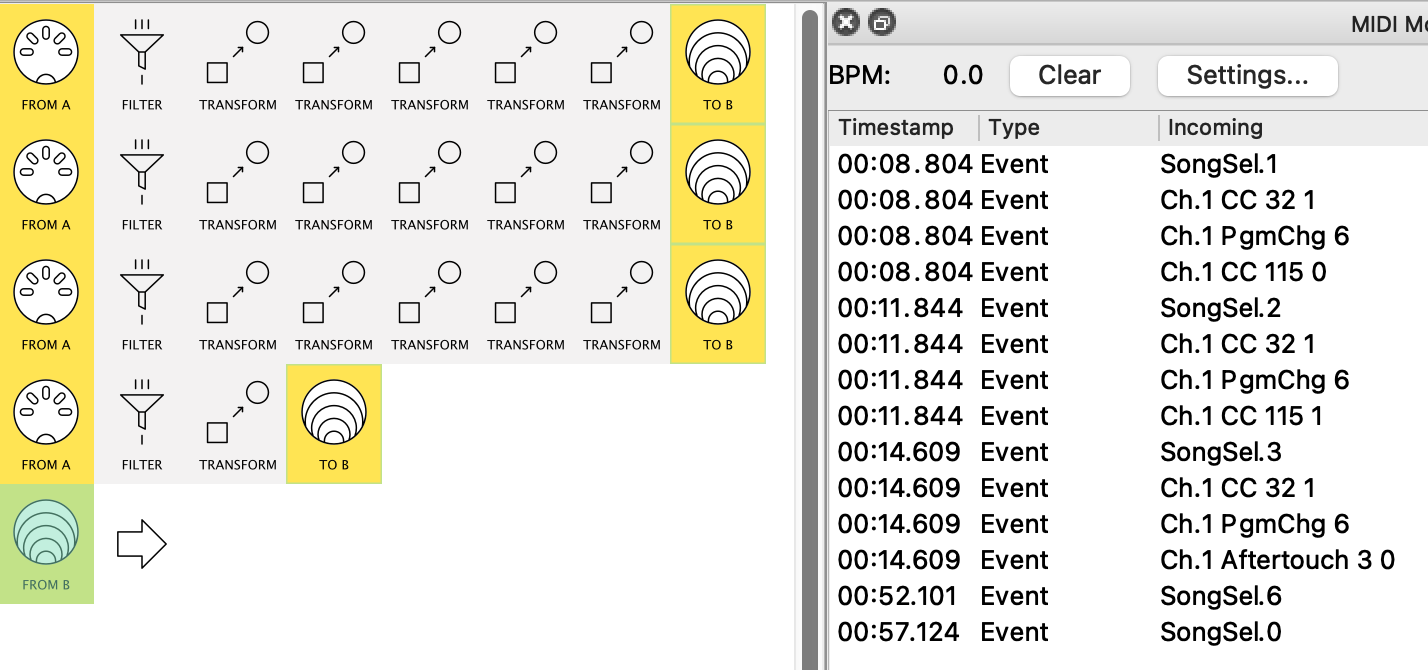

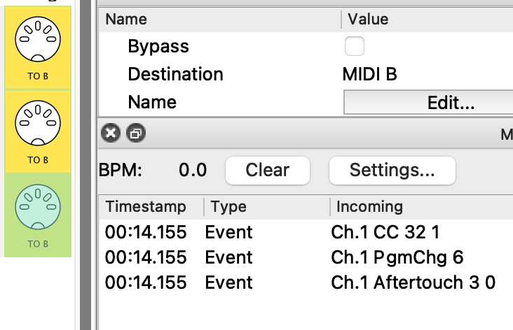

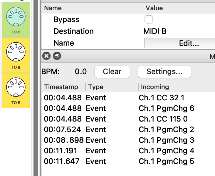

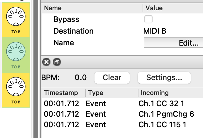

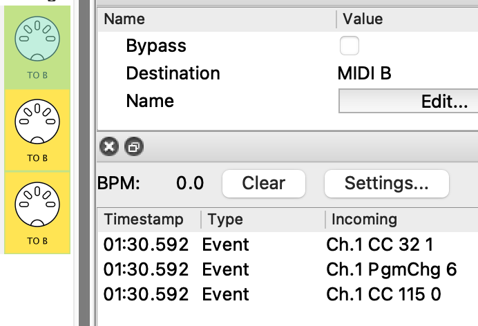

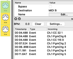

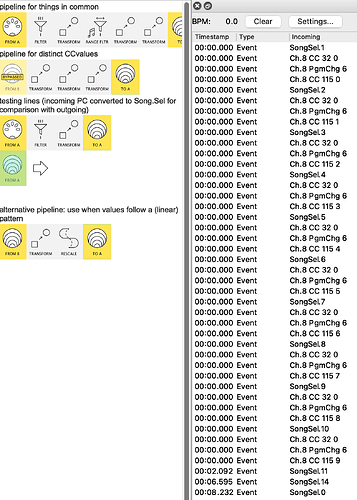

With the changed Filter, the Monitor shots…
...look like this:
PC#1 →
PC#2 →
PC#3 →
showing that you just need to correct the Work with Note Number in Range... in the 3rd line
(and maybe some Arg1’s?)
The issue I didn’t see until testing is this:
Any PC that a given pipeline doesn’t handle is just let through!

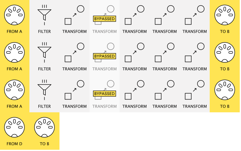

This is solved by adding a Drop Transform set to Use Program Number =Outside Range
(I show them bypassed here)

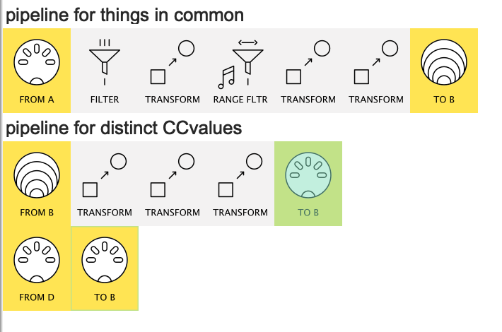

PS. here is a modified version suitable for later readers who maybe have many PC → Bank Change pairs to handle.
pc to cc conversion help 2(ResoVersion).mhp
Details

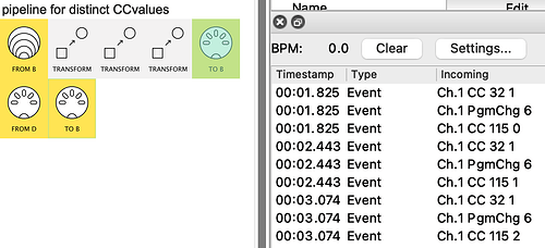

it keeps all the parts in common in the 1st pipeline (CC#32, PC#6)…
…and puts all the PC-specific CC#115 values in a 2nd line
(it could be all one pipeline, but this feels more organised)
It uses Note On instead of Poly Aftertouch just because that allows us to use Note Range Filter to discard the PC# numbers the pipeline is not meant for
here’s the testing:

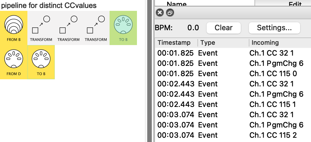

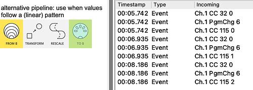

Notice this uses a Transform for each CC value. This method is necessary when there’s no relation between PC# IN and CC value OUT

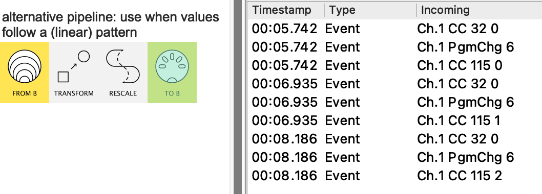

When there’s a pattern (like here: 1 → 0, 2 → 1, 3 → 2), however, we can save a bit of work with a Rescale:

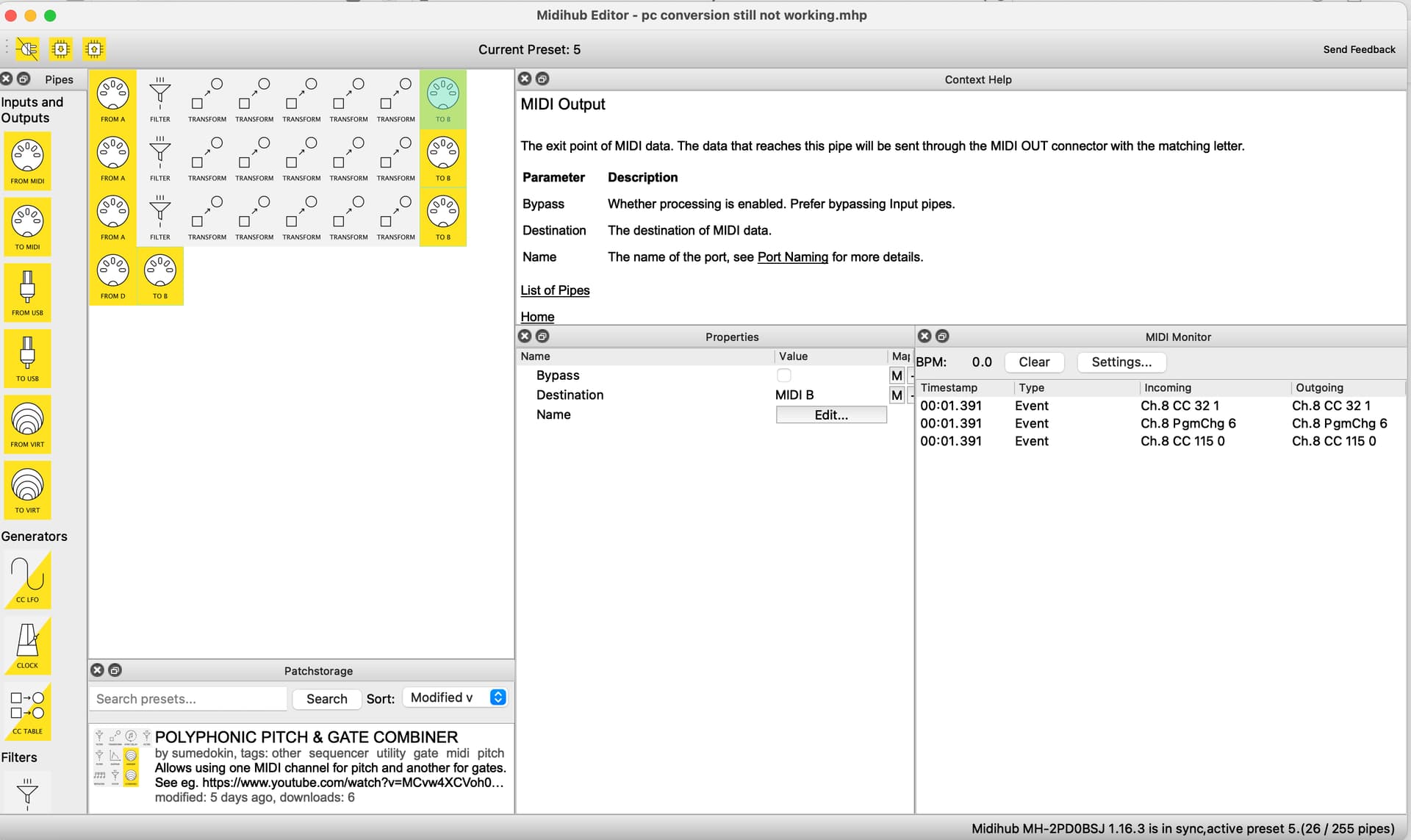

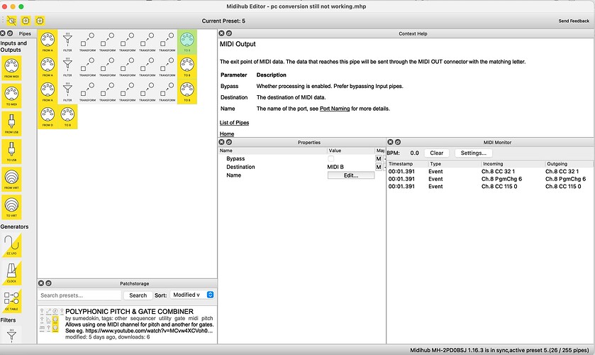

I’ve attached the pipeline i’m using with your first solution (the second one didn’t work on my end)
With this first one, pipeling 1 (PC 1 conversion) worked as intended. The rest showed no activity at all when i hit the corresponding midi buttons. What am I missing here?
pc conversion still not working.mhp (577 Bytes)

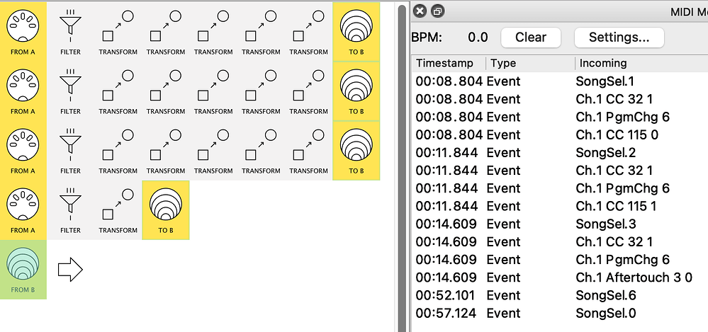

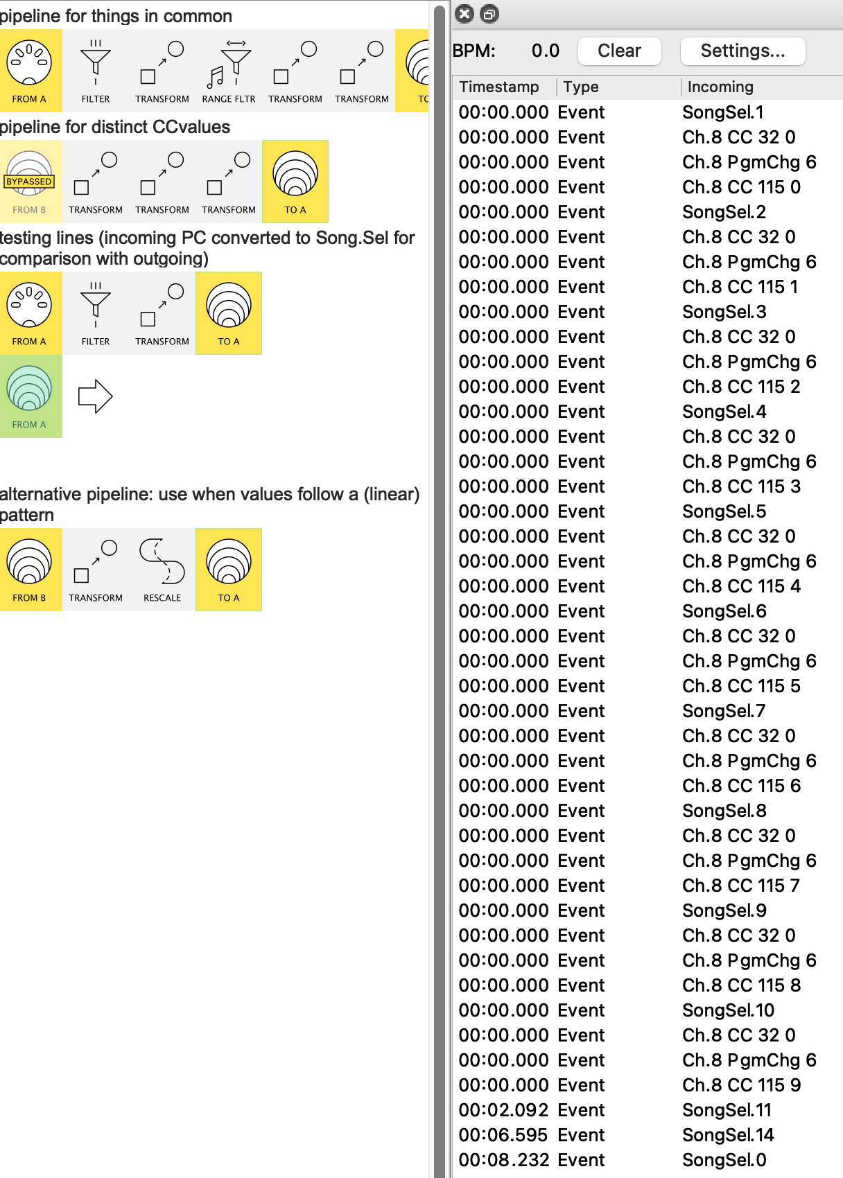

OK, here’s all the incoming PCs (changed to SongSel to distinguish) in one place
followed by the outgoing created messages
Apart from the error that’s still there…
See above: “showing that you just need to correct the Work with Note Number in Range... in the 3rd line”
…what would you expect that isn’t there?

here’s this for comparison:
Are there any unexpected messages here?
(from an edited verson of mine uploaded for later readers. )

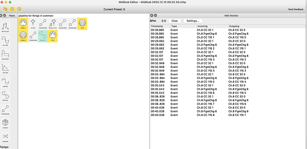

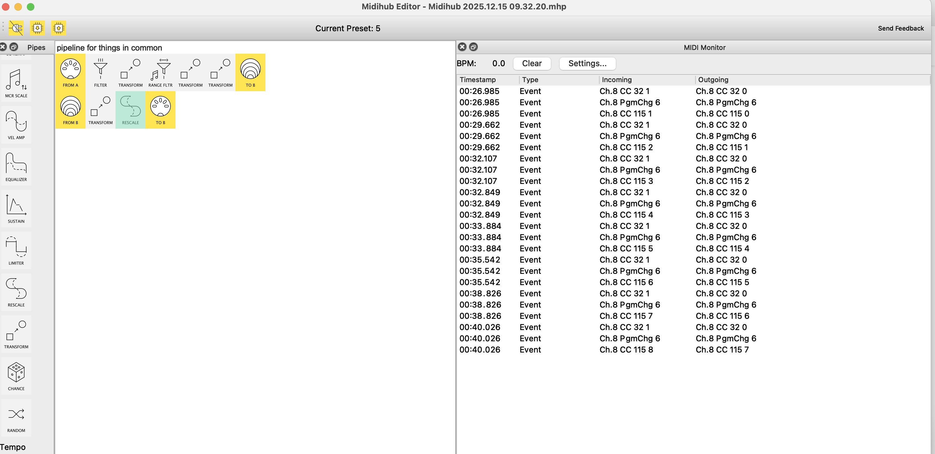

that all looks correct but when i load it in my midi hub editor it doesnt work. let me try again and upload the result
Midihub 2025.12.15 09.32.20.mhp (438 Bytes)
it is showing that the signals are being sent, and yet nothing is happening on my pedal
