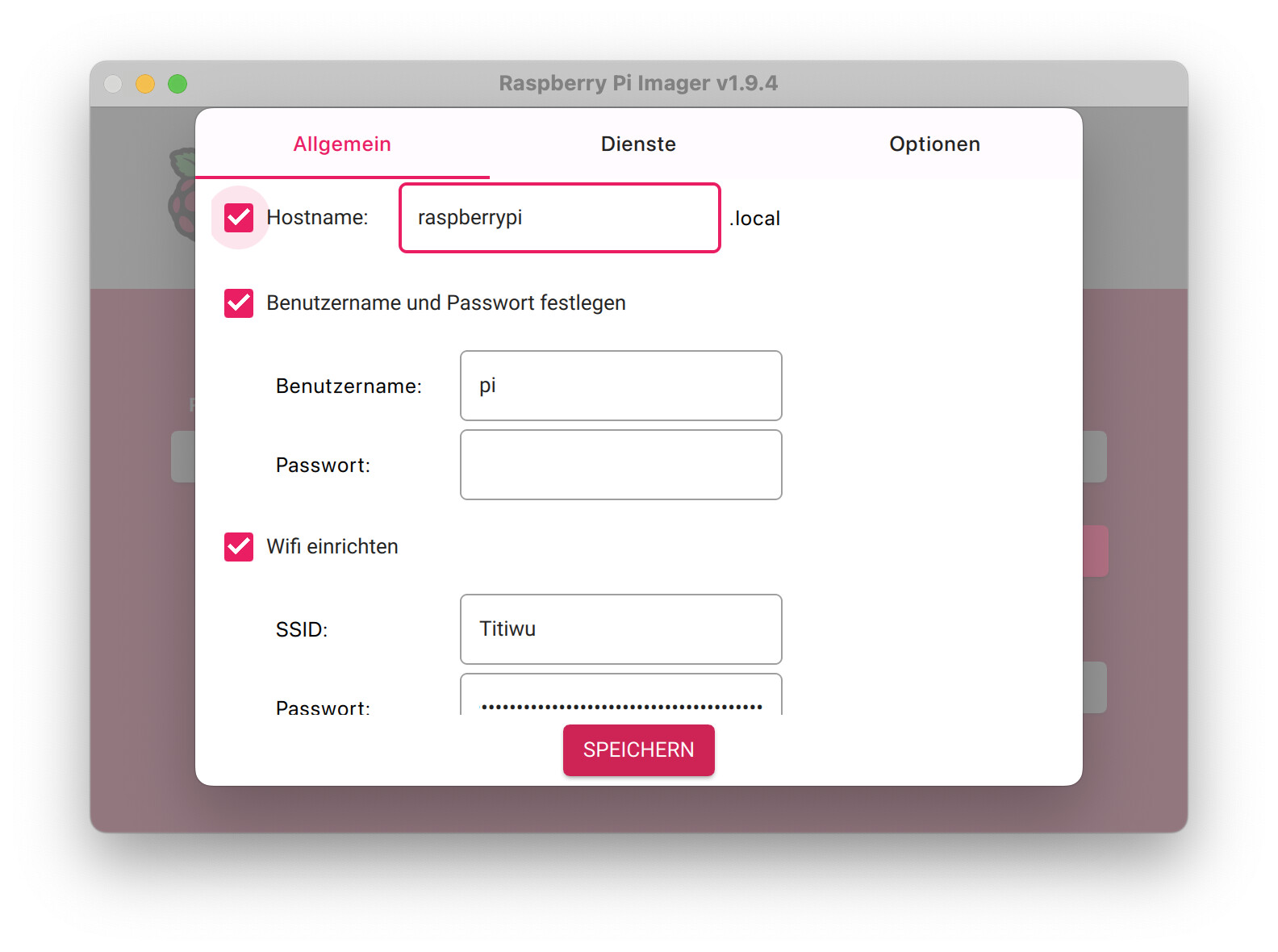

I just installed the latest image (I found here: [Beta] Patchbox OS Bookworm ARM64 2024-04-04) to my Raspberry Pi 5 and it boots, but I can’t log in using patch/blokaslabs.
Doesn’t work with direkt login or ssh.
What I saw is that the hostname is not “patchbox” but “raspberrypi”.
What can I do / check?
:man_facepalming: I didn’t know about this (anymore):
So it was me, all along.
