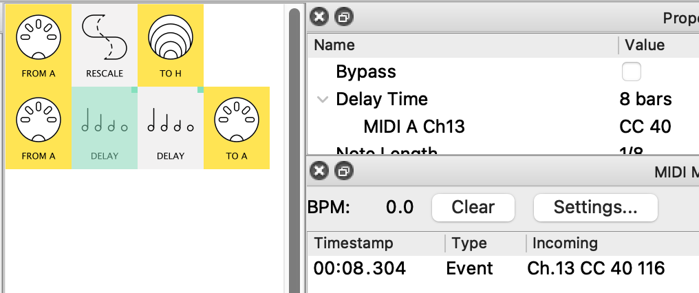

Here’s an example preset, @kamal, with two Delay pipes, side by side both with Delay Time mapped.
kamal_vm_limit.mhp

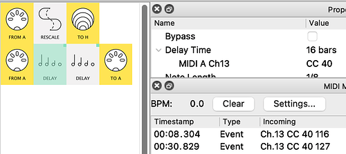

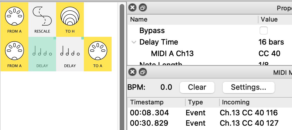

The first is mapped directly to the CC coming in MIDI-A:
see how the values 116 & 127 give times of 8bars & 16bars.

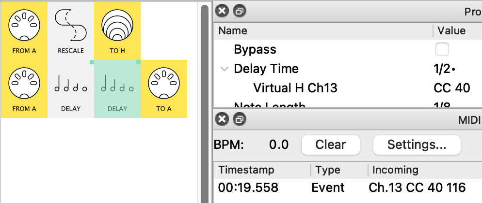

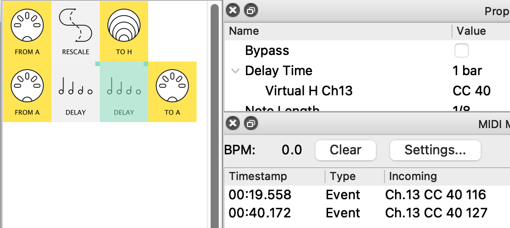

In the second version the pipe is mapped to Virtual H allowing us to modify the mapping values.
Now, although we see the same CC values in the Monitor…
..the values have been rescaled in pipeline 1 to restrict them to the values you want for the mapping:
Try setting different values in the Rescale pipe to see the different outcomes (You’ll notice I’ve restricted the Out Low range as an example)
Then maybe try used two to Rescale pipes scale down, scale up to get only some of the Delay Time values (say 1bar, 1/2, 1/4, etc)
