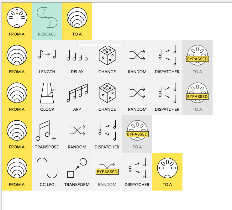

Good afternoon everyone, I wanted to ask a question. Today I was working with the Midihub and the Digitone, and I wanted to know if it’s possible to control the Digitone’s panning (cc msdb 10) using CCLFO. If so, how do I do it?
I’ll share what I did.
Digitonemulticanal.mhp (602 Bytes)
I was working on track 4, which has a pad sound, but I think it would sound better panned to the arp.
Thanks for read :smiley:
Place a CC LFO on a new line, set its ID param to 10. Then add Channel Remap In Low/High [1; 16], Out Low / High [4; 4], so the generated CC is remapped to Ch. 4 which Track 4 probably listens to (if not, check MIDI settings in Digitone) and send it out [TO MIDI A].
Also, looks like you can enable 14-bit mode on the LFO for higher precision - the Pan param accepts LSB value at CC 42 (which is the standard +32 offset from MSB value), so it should work out just fine.
Let me know how it goes. :slight_smile:
Thank you so much, it worked perfectly. I had just found a video that answered my question, but it was missing the CH Remap part.
