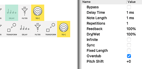

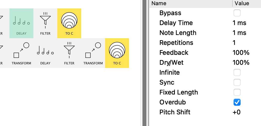

Hey @rdh, you’re on the right track with Delay, but try using the Note Delay pipe instead on a parallel pipeline:
  • Transform the CC → Note On
  • Delay the Note On by 1or 2ms
  • Discard/Filter the Note Off produced
  • Transform the Note On → CC
if you need more detailed help, please upload your current preset (and let us know what FW/Editor version you’re using)
no worries - the old method of doing a note transform seems to have cracked it, near enough. NRPN is a hot mess, not just for the MIDIHUB, - Crosstalk everywhere on the hydrasynth, but I’ll see if I can get it working.
ah yes - thanks. The trouble with that is I was trying to do it using NRPNs without a conversion to note information. (I have a controller that sends NRPN) So I wanted a CC delay. But I’ve reverted to the old method in the end. Whatever works.
