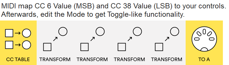

Check this out, I modernized the previous NRPN preset I linked to the CC Table times. :slight_smile:
Digitone 2 Euclidean NRPN_fixed.mhp (2.1 KB)
The way to use this preset is to MIDI map CC Table’s CC 6 Value (for MSB value part) and CC 38 Value (for LSB part). Or for experimentation purposes, you can enter values into these properties and CC Table will emit them, this way it’s easy to observe what happens in Digitone 2 exactly.
The Digitone 2 manual lacks in specifying which values are accepted for controlling the euclidean - whether it expects 0 - 1 values on the LSB part, or whether the MSB >= 64 means on, < 64 is off, and LSB is ignored, so you’ll have to experiment a little bit. Let us know what you find.

Ugh, sorry, I created it with a future version of the Editor, reattached one recreated using Midihub Editor 1.16.2
