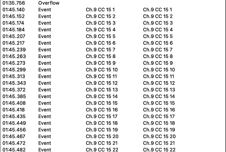

  1. please upload a screenshot of the input (with MIDI monitor) to show what the value jumps are when you depress the pedal(s) fast or medium-fast
    (whether they “jump” –say, 0, 4, 7, 13– influences the solution)

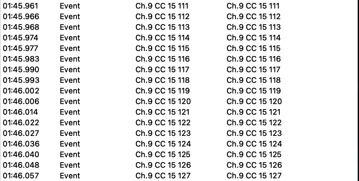

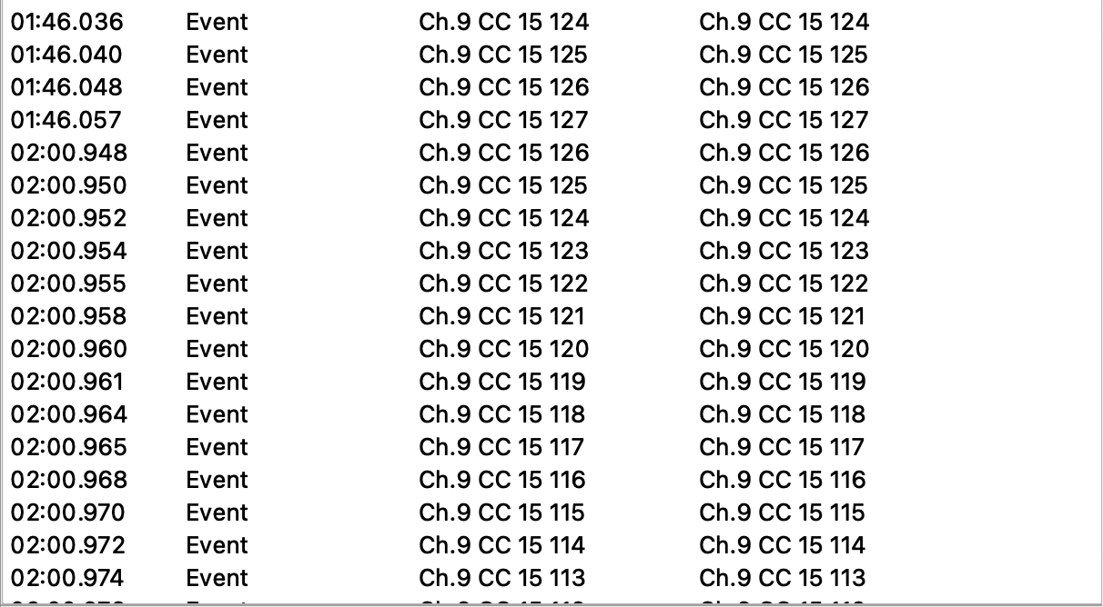

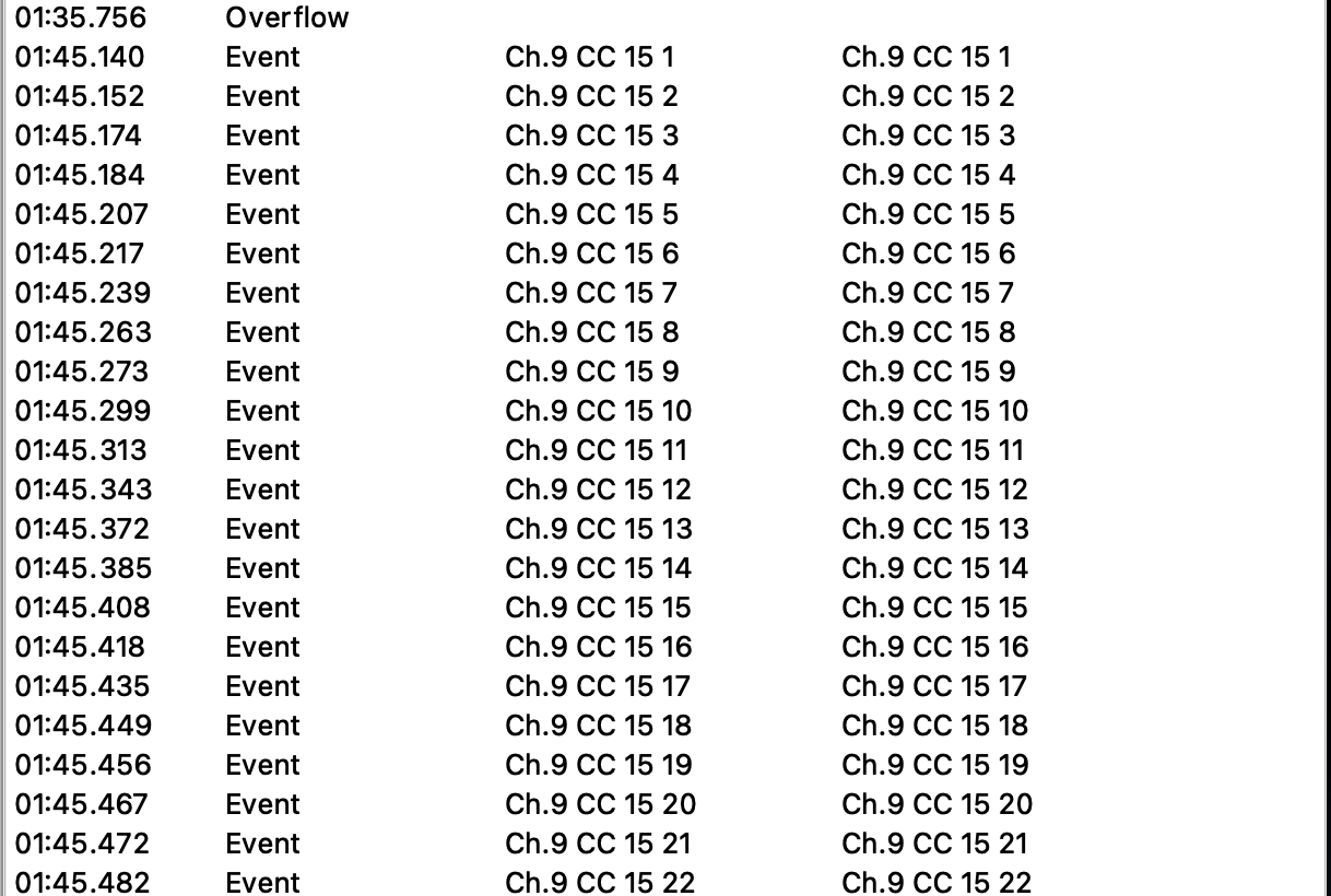

Hey! Sorry a little out of order here, but the time stamps will help you see which messages are being sent. Seems like they dont jump?
