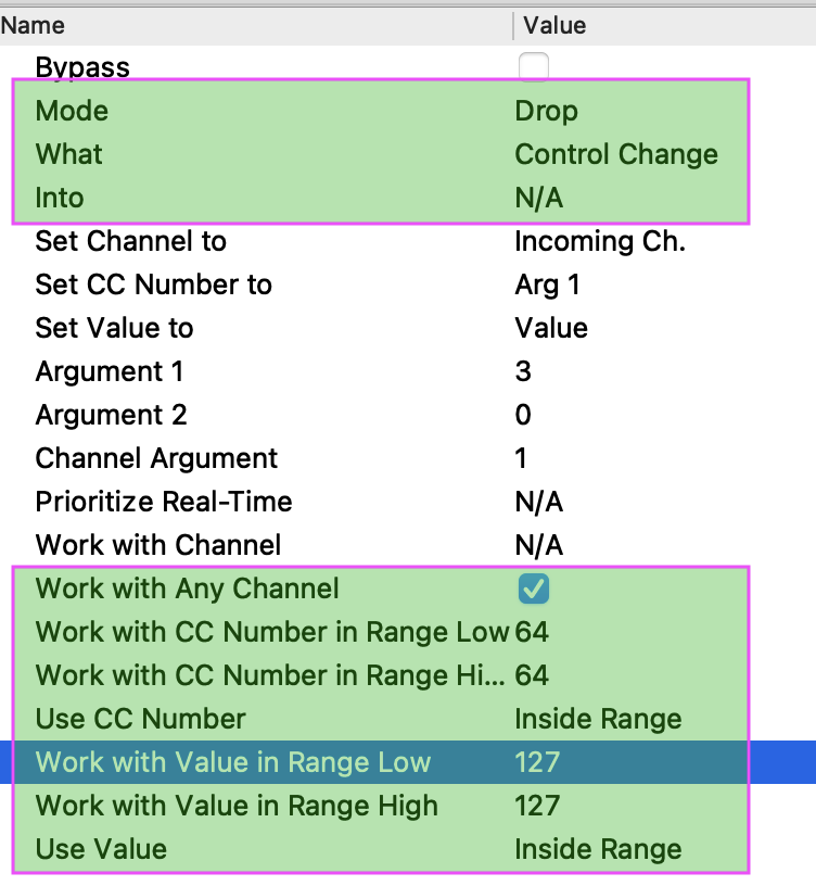

Construct this Transform:
In your case we’re really only interested the green boxes.
Look at the green box at the bottom first:
  • See how we’re telling this Transform to only work with CC 64…
  • …when its value is exactly 127
  • (note I’ve also assumed this could be on any channel)
So Transform is homing on just the message ids/values you want to deal with.
Now look at the top to see what it’s going to do when a CC arrivies fitting our critieria:
  • just “Drop” it
    (not change it into anything else, hence Into = N/A)
  • And, as we’re just Dropping/ discarding this particular message none of the other settings matter;
    (there is no Outgoing message)
