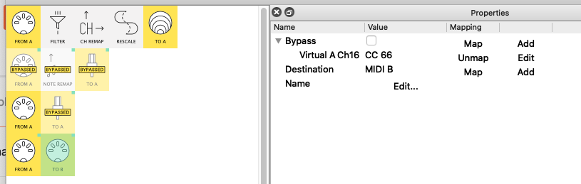

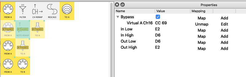

Hi All!
The first 2 lines of pipes invert incoming midi notes with an assigned cc69 toggle switch and sends them out vA.
The second two lines of pipes , when pressing an assigned cc66 toggle switch, direct midi notes to out B, and turns off out vA.
The problem is when cc 66 is depressed, the midi notes to Out B are no longer inverted when engaging cc 69. The result, in this context, tis that midi notes go out to both outputs. This is not intended.
The goal is to be able to invert the notes with CC 69 whether or not cc 66 is engaged.
works fine out vA, but, when I switch to my 2nd sound : out B
Instead of inverting the notes, it merely enables both vA and B single notes.
I can’t picture everything here, so I’ll attach the file. What am I doing wrong?
Thank you very much!

When you say vA, are you referring to USB out A or Virtual port A?
This patch would never invert the notes going out to B because there is no way for inverted notes to go out through Output port B.
What is the purpose of the final 2 lines? When you toggle on the pipes in line 2, line 3 is still sending out non-inverted notes to the same port creating chords to USB A. Is that the intention?

Alright I see then. It may be more simple to skip the last 2 lines and then map to the output port after the rescale pipe. You can switch the port’s destination on the fly. One more question. Do you want the possibility of A and B sending notes at the same time or only A or only B sending notes individually?

I’ll help you tighten this patch up now I understand your intent. This is more of a 2 line function.
Edit: One more question after getting info about your pedal. You say both buttons are momentary. So do you want A to be active at all times except for when B is active then only do the inversion while pedal is pressed? Or do you want A only to be active when the pedal is pressed.

Hmm. Does your pedal have the option to be set as toggle rather than momentary? Or to notes instead of CC? The toggle example in a earlier post only works on notes because you can drop the note off which retains the value argument in a transform pipe.
I can’t seem to figure out how to make it work with a momentary CC because you are always going to get Value 127 when pressing then value 0 when letting go. It would be much easier if you could set your pedal to toggle.
Edit: Okay I have found a new way to toggle that works with a momentary CC button. Basically it’s mapping to the bypass of the rescale pipe instead of the value in the transform pipe. So momentary buttons will work fine.

It would usually be a setting in your controller. It depends on if your controller has those options. I got the patch mostly working, I’m trying to solve one little niggling issue. If you can set CC66 to toggle the current version I have will work though.

I accounted for the inversion CC69 to be a toggle within MidiHub. It’s just switching the ports with CC66 that’s a current roadblock. If the CC66 control was a toggle instead of momentary than it wouldn’t require extra pipes to turn it into a toggle.
switch test.mhp (1.4 KB)
Test results;
-cc 69 requires two presses to switch to and from inverted notes -with both out uA and B. !

So the first pedal is already a toggle? Then it’s no need to make a toggle inside of MidiHub, you just need to map to the bypass(already done in patch). Remove the first 2 transforms(the bypassed ones) if this works.
switch test 3.mhp (1.3 KB)
