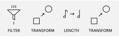

so here’s

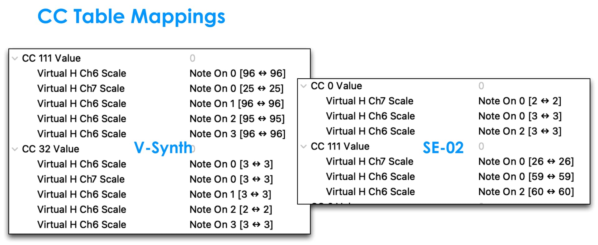

Solution 2: the CC Table method
now instead of (pretty much) a Transform for every cell in your table we have this:
…where we just need a new mapping for each value.
Notes
  • The first line is the same as before but with a “safety” filter
  • I use CC111 to carry the required PC#. These are converted later.
  • This should be a single CC → PC Transform but I need to employ a workaround…
    …to make sure the PC comes after the Bank Change
    (this may be solved later)
