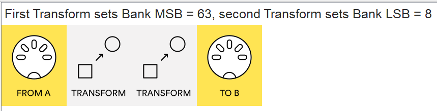

According to this Yamaha MX61 Data List, to access the user bank, the CC Bank Select MSB must be set to 63 and LSB to 8. This Midihub Preset sets these values for every Program Change event received:
preset 1 Nord -MX userbank_banksel.mhp (399 Bytes)

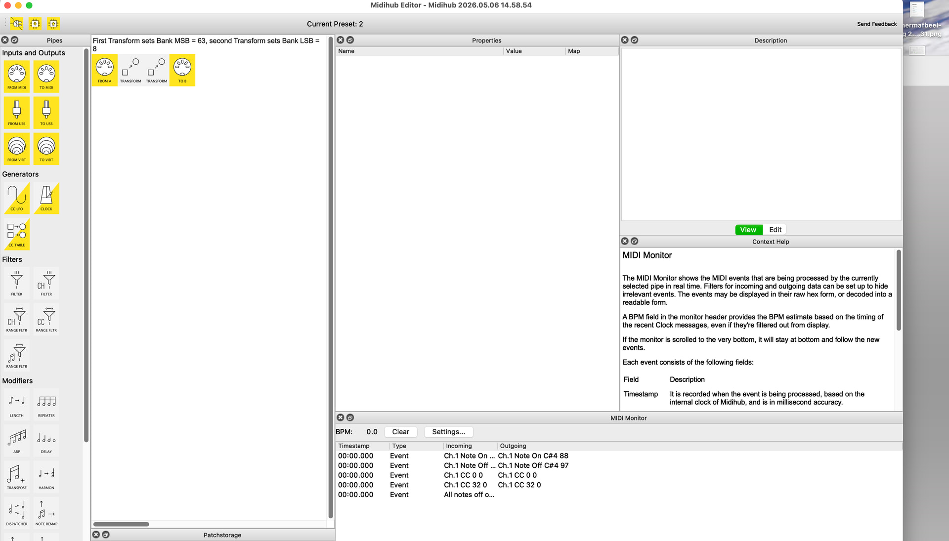

Can you please select the TO MIDI B pipe, send a program change from Nord, and send a screenshot of the Midihub Editor? The produced events should be visible in the MIDI Monitor pane.

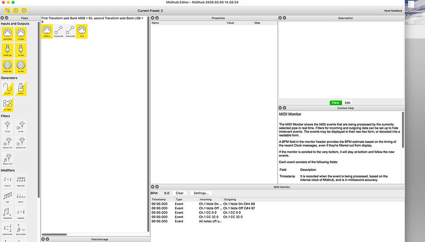

cant see a programchange just the bank select MSB and LSB
Please check if you have any filters set in the “Settings…” button in the MIDI Montior pane - maybe the program changes are getting filtered out from the display. (If a box is ticked in the incoming or outgoing filter settings, the events are hidden from MIDI Monitor)
Another thing to check - open the Device → Settings menu in the top bar - check the “Program Change Port for Preset Change” settings - in case it’s enabled for MIDI Port A, you might be unintendedly changing the presets on Midihub with Program Change 0 - 7 events. If that’s the case, you should set it to “Disabled” or non-MIDI A port.
If that still doesn’t help, could you please repeat and select the FROM A port to detect the incoming events right at their source and post a screenshot?
