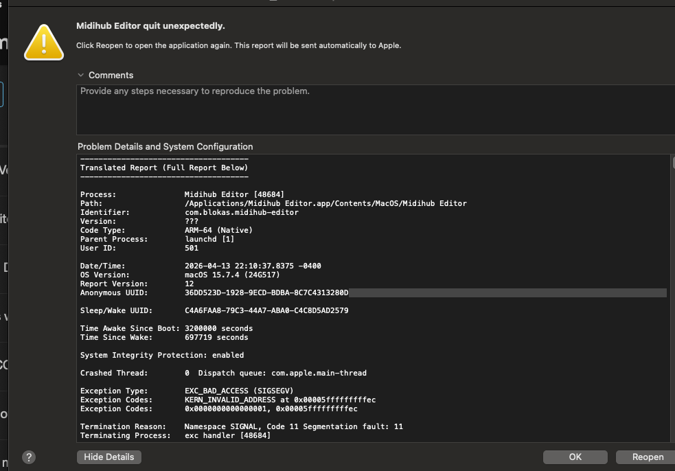

Midihub 1.16.2 crashing numerous times a night
Mac M3 os 15.7.4.
48Gb ram
Is anyone else having this. It is fairly constant.
Hi, this sounds like the issue reported here: Midihub editor crashes often (macos tahoe 26.2)
I am still waiting for more information on it, I sent you a PM as well.
except, I have avoided upgrading to OS 26. I am in OS 15 and it’s still crashing.
Yes, some crash logs would help me fix the crashes :slight_smile:
Ok, @sozinizos sent me the necessary logs, it looks like we have a potential fix for the issue, I’ll include it in the next Editor update.

i don’t know how to send you the crash reports - they only want to go to apple.
