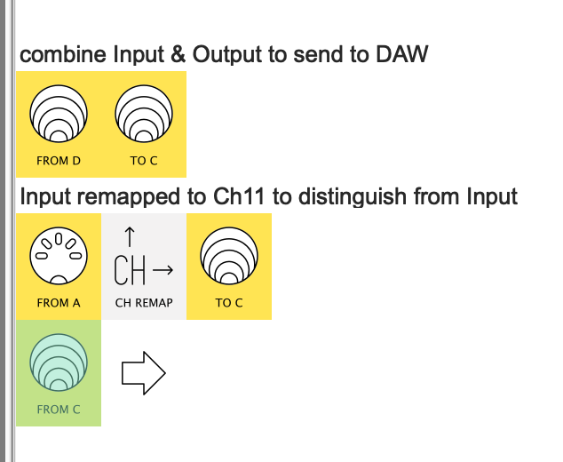

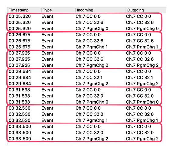

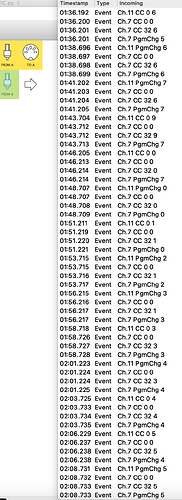

Yes this is what I got from your input yesterday:
(where the Input has been remapped to Ch11 for comparison)
all is working as expected. (rather pleasing to see it all match up :smiley: )

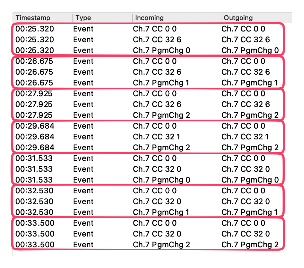

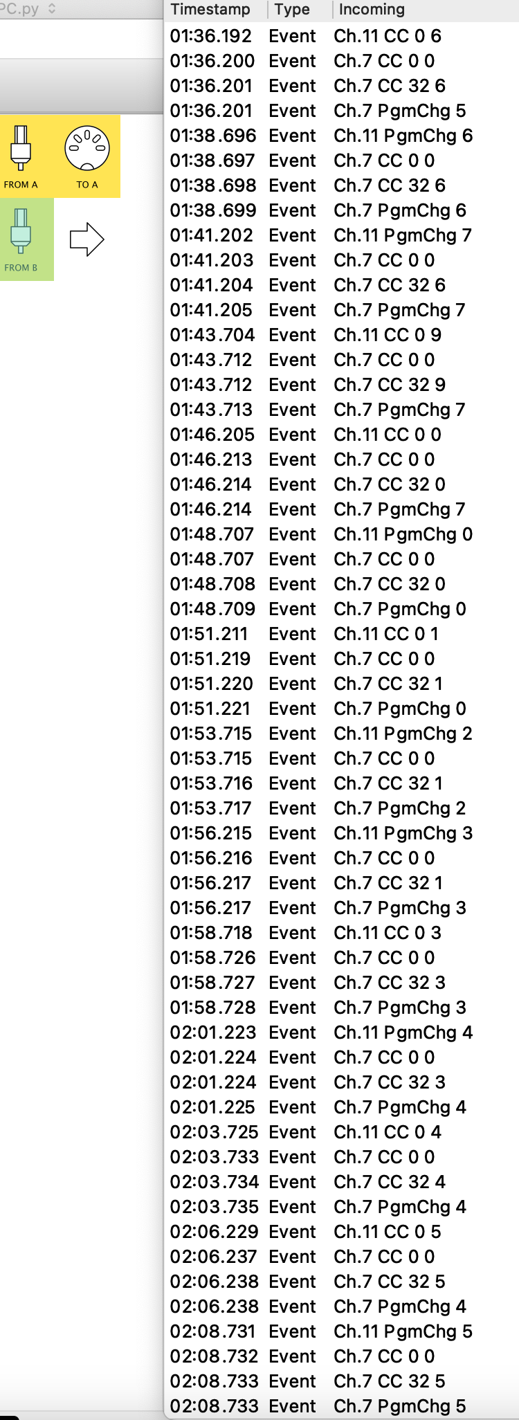

Ok, I’ve found an issue: The first time you power on the MH (or when loading the patch from file, I detected this when appending it to my preset) it will always load Bank 6, if you send PCs with same bank it will not recognize the Bank, and it will keep sending Bank 6. This happens until you send another Bank. So in this example:
I’m sending in this order:
B0 P0 → sends Bank6 P0
B0 P1 → sends Bank6 P1
B0 P2 → sends Bank6 P2
B1 P2 → this fixes it!
B0 P0 → Correct
B0 P1 → Correct
B0 P2 → Correct
Any idea?

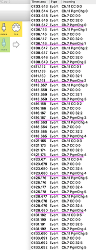

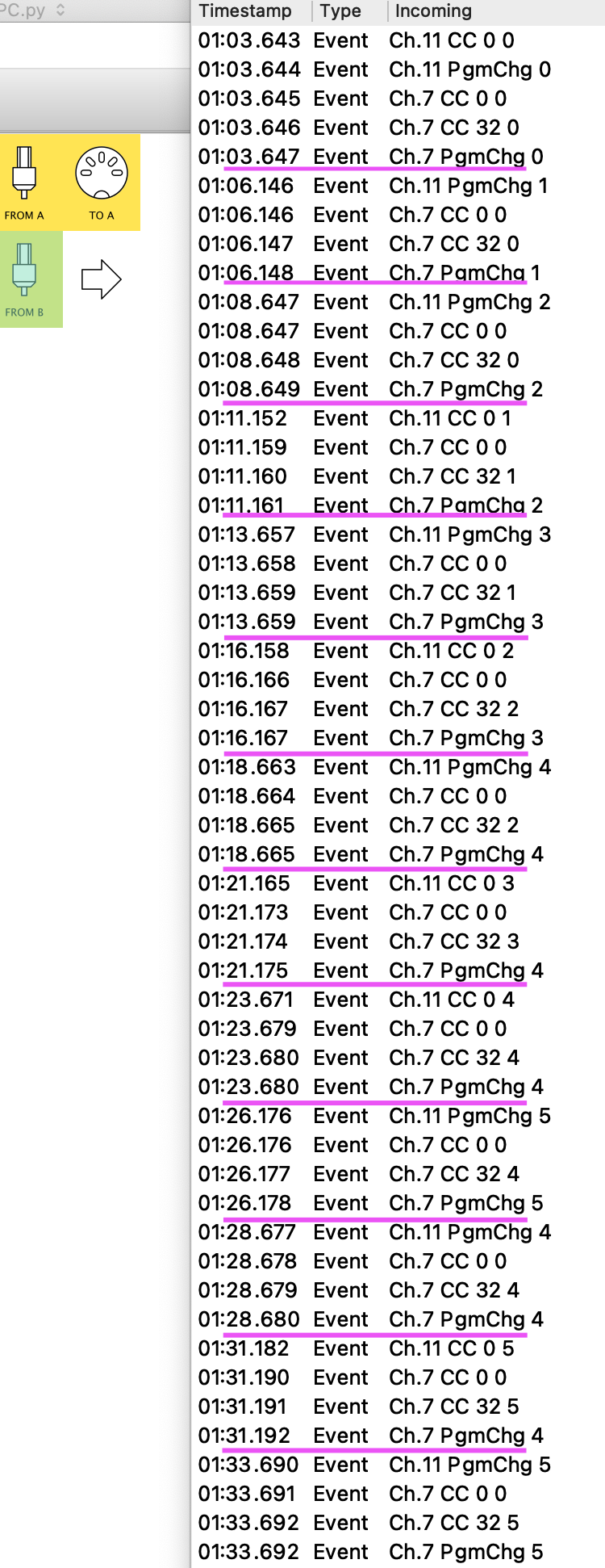

hard to know without seeing the input too.
The preset assumes that the first messages it is sent will include both CC0 & PC. Thus MH should be on and connected before first OT messages are sent.
Are you saying these are ignored?

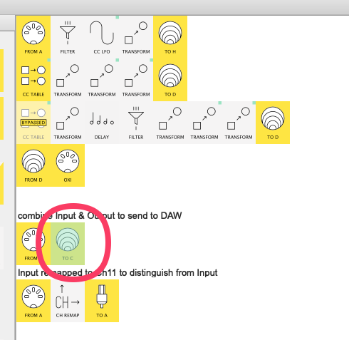

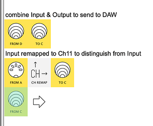

Pls send shot of both Input & Output merged
eg:

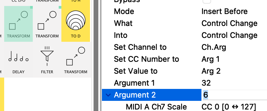

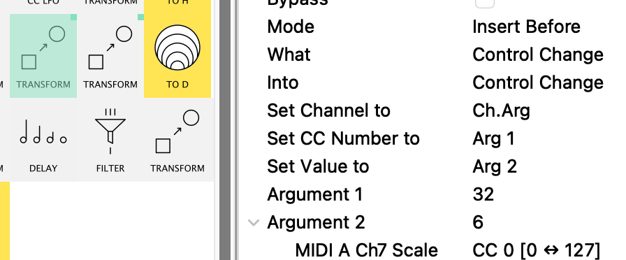

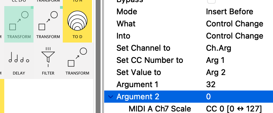

Back to your initial values:
Obviously, as we’re using mapped Transform Arguments to store state, their initial state will simply be those it was saved with.
So if you want to start at, say, 0 just manually set these❖ and save the preset before further testing.
❖ like this:
So, change the value while leaving the mapping assignment unedited
