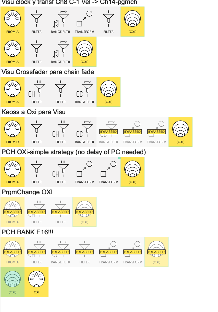

OK, just checking out the ā€œSend CC0-CC32-PC on either inputā€ version.
Will upload without comments as I see you’re full.
PS. I see you have two long Init lines. CCTable nows makes this easier.
If you like, I’ll show you an example when we solved this…
Yes, I know! you already showed me how to do that in other post, but because it’s working as it is and I have been busy/lazy, I haven’t looked into - but probably will need to when I cannot add anything more :smiley:

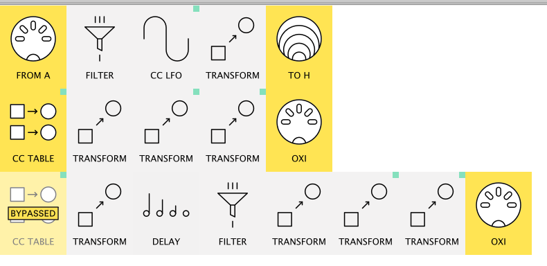

pipelines:
  1. sets triggers for Tables below. creates a mapping to store PC#
  2. CCtable triggered by both CC ā€˜Timer’ and PC value CC
  3. 2nd version which uses a Note thus allowing a (2ms) staggered message triple.
I wrote the Note-Delay line from the suspicion that OXI might be happier if the 3 messages were staggered. Delay can be set to 1ms if you like.
Swap the Bypass if the simpler line 1 fails
If it works, I’ll add an explanation… :smiley:

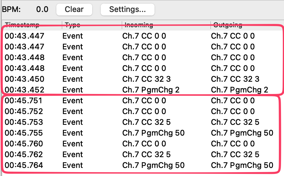

Still fails :frowning: It fails in the scenario where you send a different Bank number with same Pgm. Here I’m sending Bank 3 Pgm 2 and Bank 4 Pgm 2, and it produces these two blocks:
Also every pgm change sent generates 3 pgm changes (i guess it’s part of the game :slight_smile: )
I’ve tested with several programs and it seems the bank is correctly selected, but the Program is always 50, as in the example above
and this is the same test with the long line:

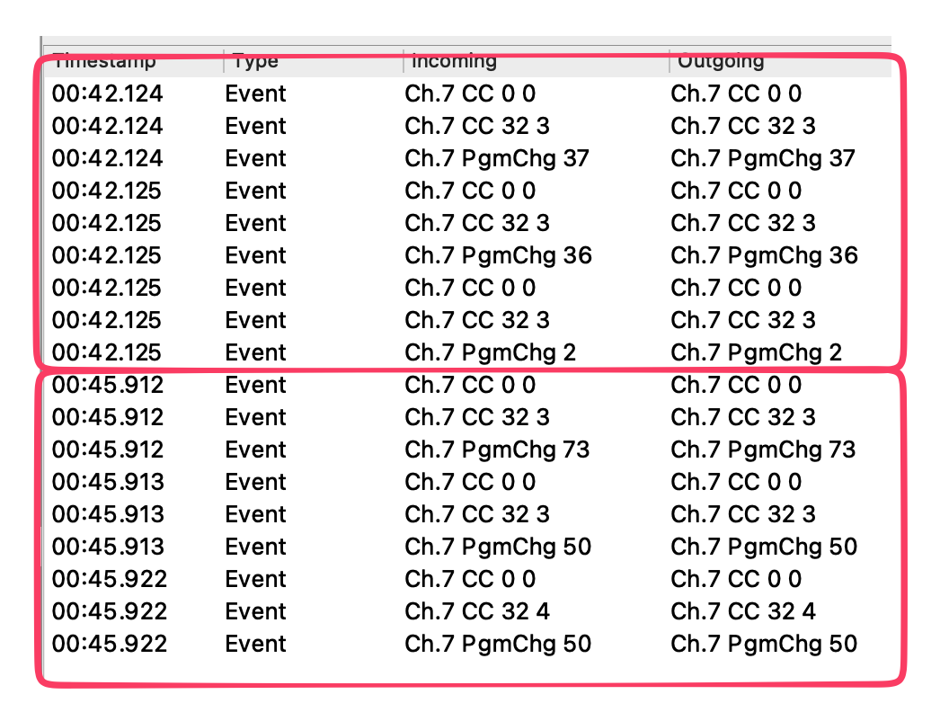

OK, let me test it with your input (difficult to replicate without an OT):
  • select a MIDI-A-IN
  • do some bank changes with a short pause between each
  • if there are extra messages (eg Clock) coming in, Filter them out with MIDI Monitor → Settings → Incoming Filters
  • when you’ve got enough lines, do MIDI Monitor → Settings → Export as CSV and send me the file
OT-PC.xlsx.zip (7.8 KB)
here it is- I also added two columns at the beginning stating the bank and program sent every time, I guess that helps. Let me know if you need anything else

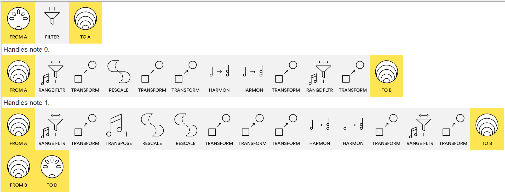

Here’s my take, I hope I understood the assignment. :smiley:
12 PGM Per Bank.mhp (679 Bytes)
This implements formulas:
Bank MSB = 0
Bank LSB = Velocity / 12
Program change = Velocity Modulo 12
The division is done by Rescale pipe.
The modulo is done by a Harmonizer and Note Range Filter trick.
Note 0 deals with the first 128 programs.
Note 1 deals with the remainig programs.
edit: I probably screwed up with Velocity = 0 notes, I guess Octratrack won’t be able to produce such an event on demand. But still, you could check if this solution is otherwise promising, we can probably adjust a little bit to make it fit without 0 velocity notes. :slight_smile:

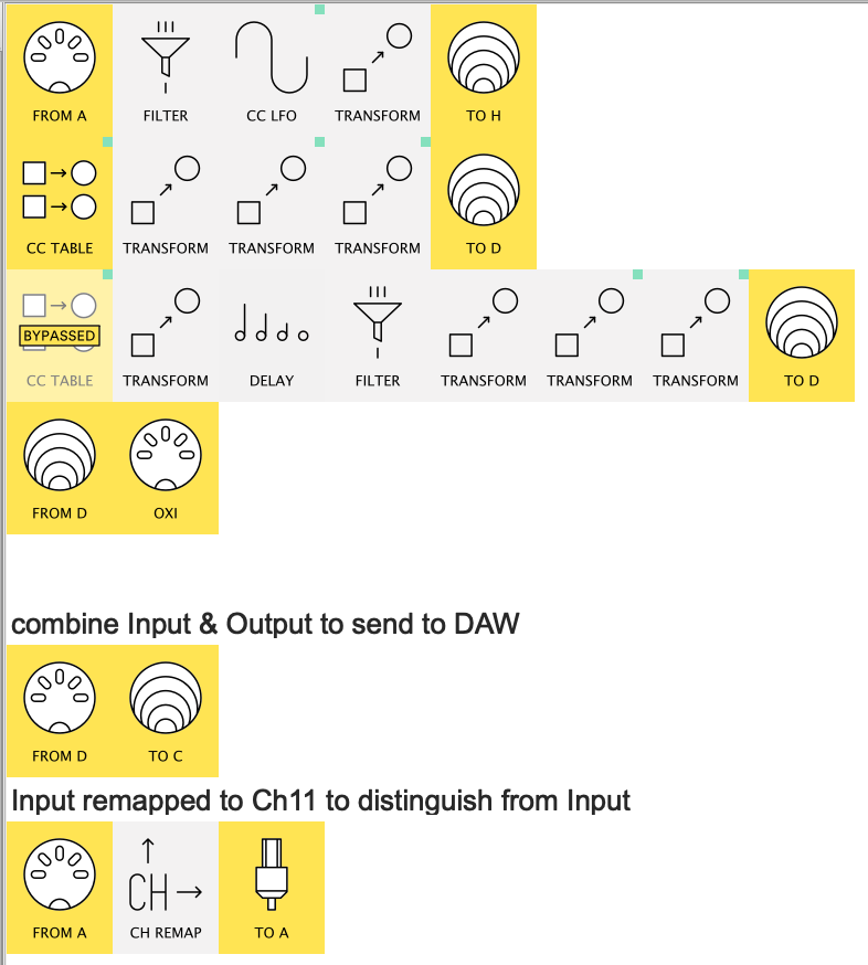

If you get the time, I’d appreciate a MIDI file from this:
Mapped_Pch_TriggerVersions_DAW.mhp
As you can see the main functionality is identical…
…but the last lines allow both the Input and Output to be recorded in a DAW.
The resultant MIDI file will then allow me to try to replicate the weird values
