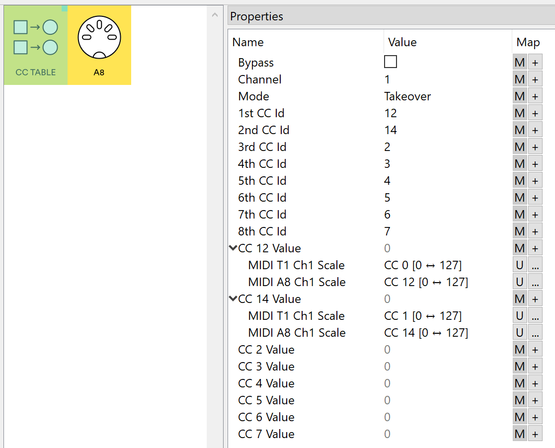

Here’s a two parameter example on how to go about this:
This is set up to share controls of Distortion (CC #12) and Osc 1 Tune (CC #14). The remaining 6 CC Table slots are in default state, ready for customization.
The main thing for making use of the Takeover mode is to make multiple mappings to the same parameter.
At the moment if you change the preset on the synth and move the knobs, it won’t automatically ‘take control ownership’ away from T1 if it already had it, but I think we should implement a new Mode for CC Table called “1st Mapping Priority” which would allow for the very first mapping to always take ownership of the value which would be ideal for your use case.
