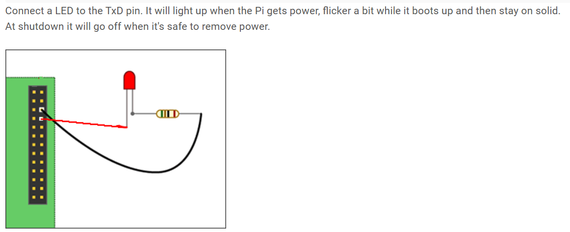

I think i’ll just take the status of that Pi LED then and use that as per this suggestion:

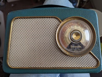

I’m turning an old radio into a mini MODEP guitar amp, will share in full when finished.
