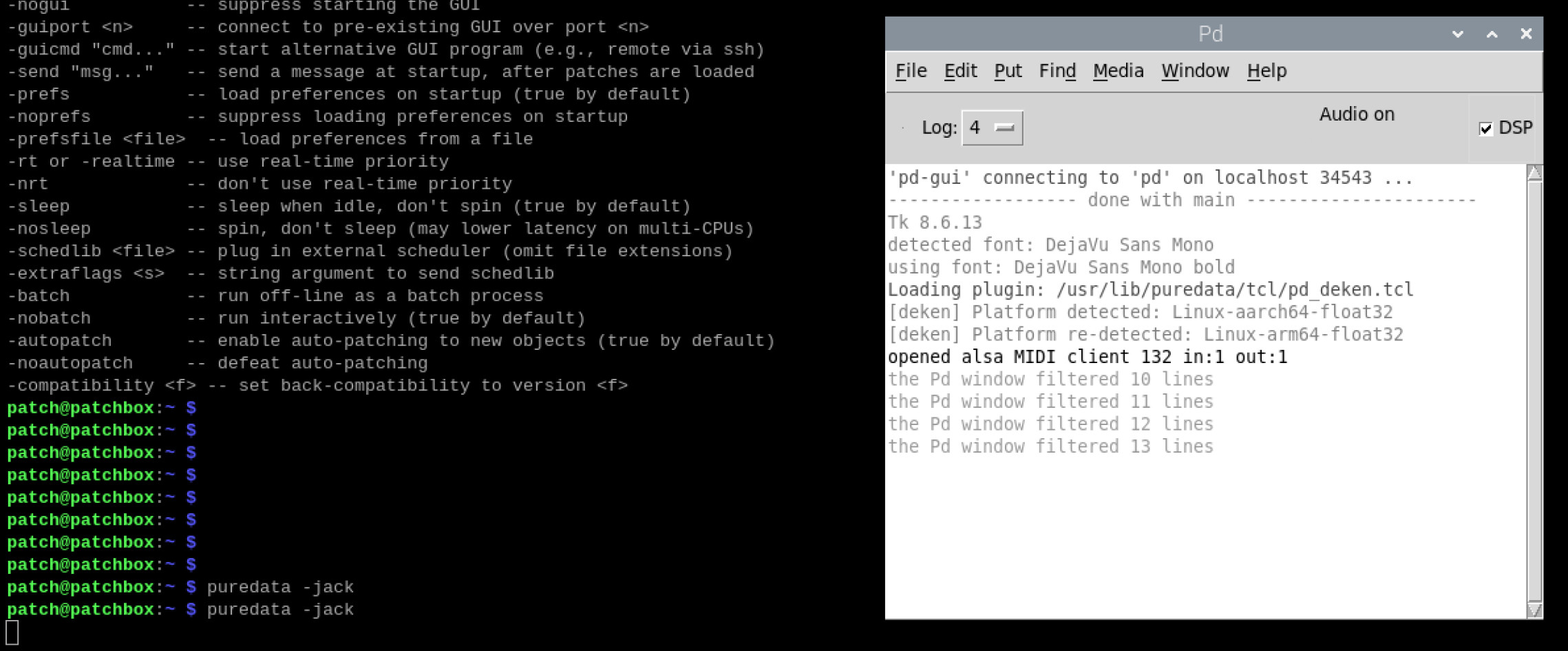

Why is puredata set to jack if puredata has no -jack flag
I tested modep and it works fine, so I wondered why I did not have any audio input from pd adc~ object
looking at the startup file, I see no -jack flag on the pd startup line
while in the ui audio settings, pd is set to jack by default
what am I missing here ?
note : this is a rather fresh install of pisound, even starting it with -jack I dont see anything in the log window (even if this line is in the help : -jack use JACK audio API)
thanks for your help
